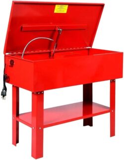

In cases of high-volume production, cleaning parts manually might not be the most suitable idea. The best solution is immersion cleaning, a form of batch-cleaning that involves submerging parts in a liquid cleaning agent.
The most common way to do this is by submerging the part in a parts washer like the one below that is filled with a mix of heated water and solvent (this is what we recommend).
Goplus 40 Gallon Parts Washer
ORDER NOW
Let your parts soak for about 10 minutes and then rinse and dry them.
