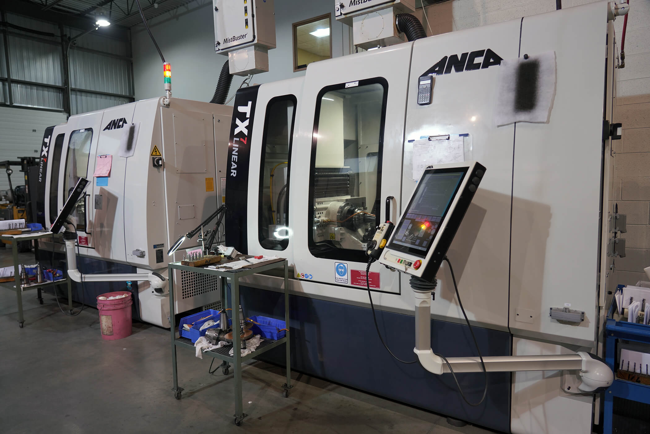

Currently, the job shop is equipped with CNC lathes, milling machines, cylindrical grinders, tool and cutter grinders and six 8-axis NC ANCA grinding machines (two TG7 Plus grinders, two TX7 machines and two TX7 Linear machines).
While Clortech uses all of its ANCA machines, Patrick Mattei pointed out that more complex/ higher volume parts are manufactured on the ANCA MX7 Linear due to its speed, precision and software which is more detailed than older machines.  The machines are used to make round tools such as: endmills, drills and reamers. Most are solid carbide, while some have carbide tips. All tools are manufactured to customer specifications.

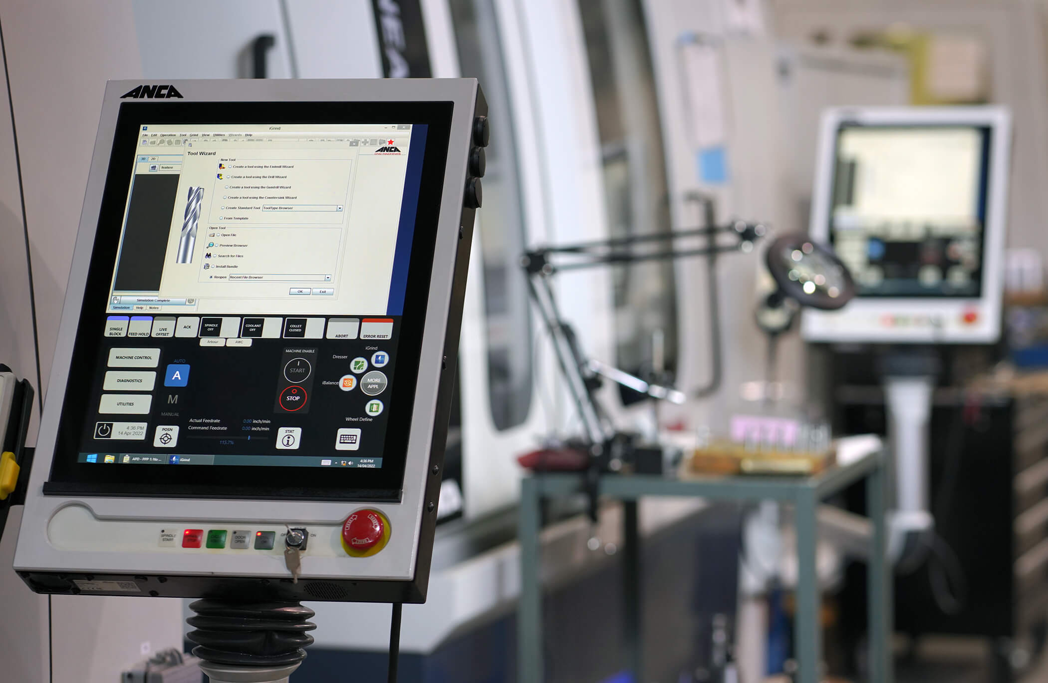

Discussing what features stand out on the MX7 Linear, Patrick mentioned the Toolroom software, which allows them to simulate a tool before making it. This greatly reduces scrap. The program’s integrated 3D graphics make on-machine programming easy, as grinding simulation is performed after any parameter change providing instant feedback. When they are satisfied with the geometry, operators take that program and put it on the machine to run it.  “The simulation software and offline programming is a very strong feature allowing the machine to run while [operators] work on other programs for different parts that they will be running later.  The versatility with lots of axes allow them to make the most intricate type parts.”  The importance of the software is further evidenced by the fact that raw materials are very expensive and hard to come by so the ability to run a 3D model of the tool beforehand makes a big difference.  Most of the company’s tools are designed from A to Z, offering a turnkey solution. The 3D model can be taken to the customer, and they can simulate the cutting conditions in their machine tool. Thus, Clortech can give the customer something before the actual part is delivered.
