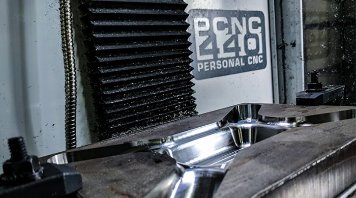

Moldmaking requires design and precision on a number of levels. Obviously, you want the cavity (the area that will form your part) to be accurate, but it can be argued that proper venting (a design feature that allows air to escape while the mold fills), runner balance (the channels which your material flows to fill the mold), and flow (how the part material fills the mold) are just as, if not more, important than the cavity itself – depending on your part and industry, of course.

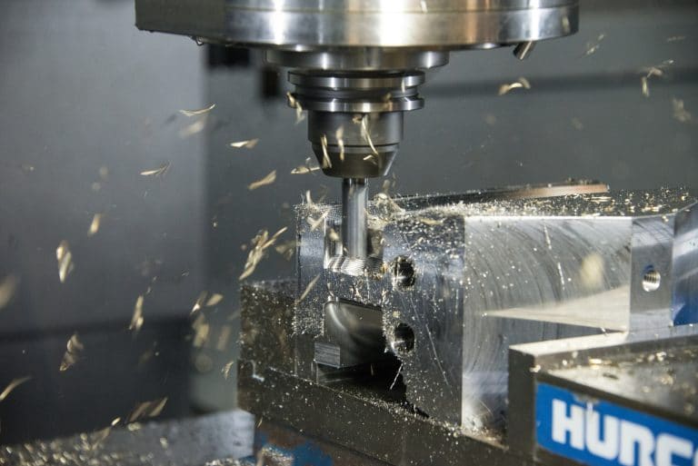

While CNC machining contributes to the accuracy of your cavity, it can also play a vital role in other important features.
Surface finish within a mold often needs to be seriously considered. Different materials, different industries, and even different features require specific surface finishes. Often, molds require hand-finishing, but the right CNC tools can get you closer to a desired finish, which means less time and effort doing work by hand.
Tools like bull-nosed end mills have a radius on the corners to help give contoured surfaces and tight crevices a smoother finish. Surface finish is important to consider because your part material can get caught in these areas while a mold is filling, these areas might be hard to fill, and/or these areas may present a challenge during release when your part is cured.
When you’re working with contoured and 3D-shaped elements, a ball end mill or ball cutter is also a useful tool to have at your disposal. As is an insert cutter, since they quite good at removing a lot of material.
