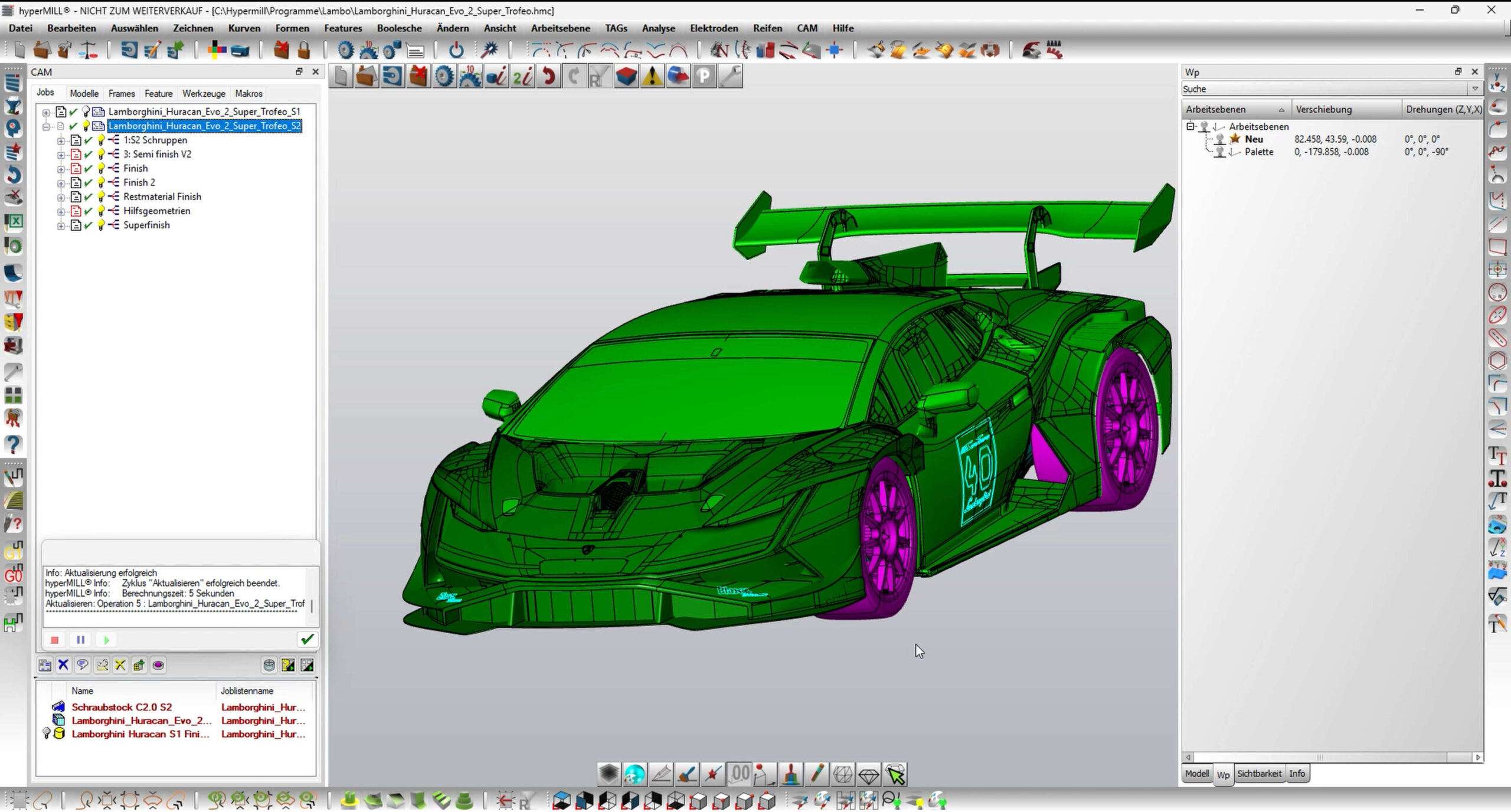

Blaser’s in-house machinists began by analyzing photos and videos of the racecar. Using hyperMILL software from Open Mind Technologies, the team meticulously modeled the car and developed the program required to machine it from a solid block of 6082 aluminum.
The Lamborghini was modeled and programmed using hyperMILL 2024 software from Open Mind Technologies.
Tool path clearance was a particular challenge. The 2024 release of hyperMILL saved enormous amounts of time by seamlessly linking CAD functionality to CAM programming. The intricate process involved one month of designing and programming, ensuring every detail of the race car was accurately captured.
