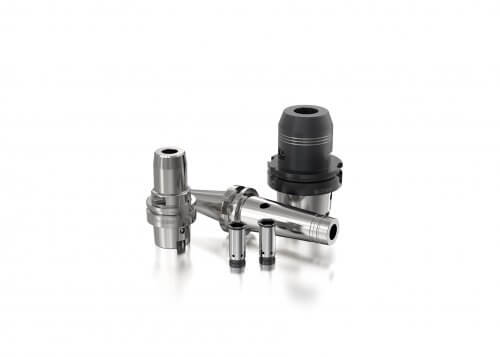

Enter HAIMER’s Shrink Fit Collet System, an innovative approach designed to address these shortcomings and enhance machining efficiency. HAIMER is very proud of their solution to the traditional collet and the challenges their use entails. Manfred Mayr, Head of Machining at HAIMER in Germany, explains:
“HAIMER Shrink Fit collets have been a game-changer for our production. Compared to traditional ER collets, we’ve seen a significant boost in machining accuracy and reliability. The elimination of tool pullout and the consistent performance under high-precision conditions have allowed us to reduce downtime and improve overall efficiency. By implementing these into our daily production process, we’re not just meeting industry standards – we’re setting new benchmarks for precision and productivity.”

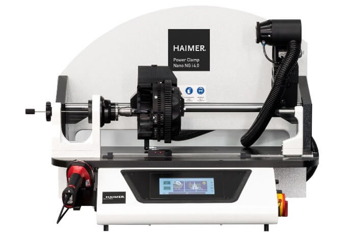

Figure 2 – The HAIMER Powerclamp Nano NG i4.0
The first step in our analysis involved setting up all Shrink Fit collets on the HAIMER Power Clamp Nano NG i4.0. The setup times for each collet system were recorded to provide as many insights into efficiency as possible. HAIMER’s Shrink Fit Collets required an average of one minute and 35 seconds to set up using the Heat Shrink machine, plus an additional 30 seconds to secure them in the holder. In comparison, traditional ER32 collets took an average of one minute and 18 seconds to set up directly in the machine. While the traditional ER32 collets had a slightly quicker setup time, it’s important to note that the HAIMER Shrink Fit Collet holders can be pre-set offline. This feature can significantly streamline the machining process by reducing downtime.

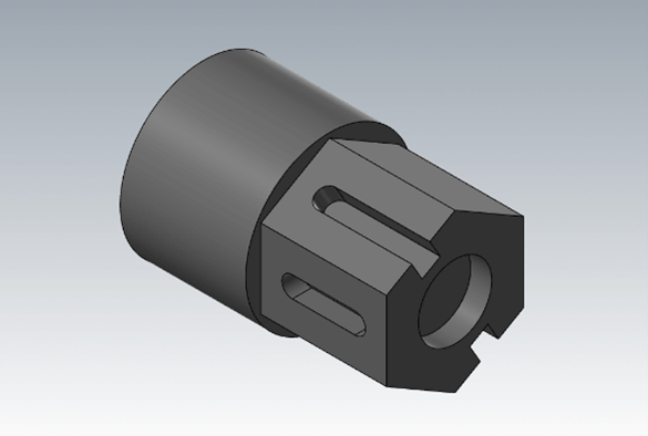

With design approval from HAIMER, OMIC R&D created a facsimile part to put both collet systems to the test. We wanted to make sure this test would incorporate as many different surfaces as we could to get a full picture of how these collets would compare. This part included various features such as Flats, Open and Closed Side Pockets, and Face Pockets, each requiring those different endmill diameters (1/2″, 3/8”, and 1/4”, respectively). We created four identical parts that were going to be used with each of the endmills. For the material, we used four-inch diameter 4140 steel workpieces, prepped and provided by OMIC R&D. This choice of material ensured consistency and reliability in our testing conditions.
Figure 3 – facsimile part design

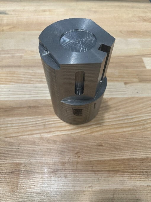

When using traditional ER32 collets, we encountered several challenges that will likely be recognizable. Tool pullout was a consistent issue during the machining of Flats. This phenomenon, where the tool slips out of the collet during operation, can severely impact machining accuracy and surface finish. Similarly, when machining the Side Pockets, tools exhibited movement within the collet system, both pushing and pulling, leading to inconsistencies.
Figure 4 – facsimile part failure when using traditional ER32 collet.
The Face Pocket operations further showcased the limitations of traditional ER32 collets. While one part was successfully machined, another exhibited tool movement, resulting in inaccuracies. During the machining of parts 1 and 2, tool pullout was frequent, with the maximum observed pullout reaching 0.2304”. Horsepower draw during these operations was inconsistent, reflecting the unstable nature of tool engagement.
The most severe incident resulted in a tool breaking mid-cut, forcing the test to come to a halt and underscoring the potential risks associated with this collet system.

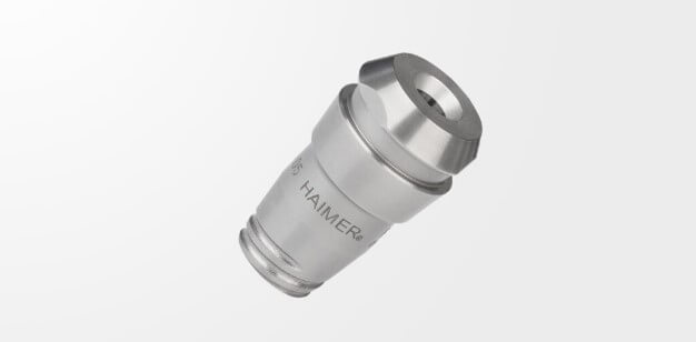

Figure 5 – Haimer Heat Shrink Collet
The findings from this study provide a clear and factual comparison between traditional ER32 collets and HAIMER’s Shrink Fit Collet System. While traditional collets offer ease of use and marginally quicker setup times, they exhibited significant tool movement and pullout, affecting machine accuracy and consistency. This can be an enormous risk when working on expensive materials. On the other hand, the HAIMER Shrink Fit Collet System demonstrated superior performance, with no tool movement and consistent machining accuracy.
