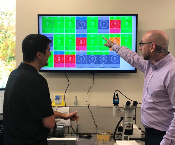

Paul Cabral and Jake Perry, two of AccuRounds’ process engineers, review MachineMetrics’ real-time machine monitoring dashboards.

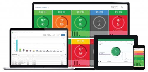

After looking at a couple of different machine monitoring systems, Mr. Tamasi says that MachineMetrics “felt right to us.” The fact that it too is a Massachusetts-based company was a nice bonus. Another was the platform’s open architecture. “If we come up with an idea and MachineMetrics implements it, then everybody wins,” he says. “Likewise, if there’s another customer that comes up with something, MachineMetrics just opens it up to everyone so we get to take advantage of that. That’s not a philosophy of, ‘We’re going to keep things secret.’ It’s a sharing environment.” That sharing culture was what Mr. Tamasi hoped to achieve with the software’s implementation in AccuRounds as well.

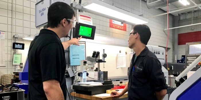

Mr. Cabral discusses run rates using MachineMetrics’ Operator View with Thu, a machine operator.

Mr. Tamasi was not naive about the potential morale hurdles such changes might bring. “I think one of the challenges through implementation was getting past the whole human element of, ‘Why are you watching what I’m doing?’” he says.  For example, when individuals run two machines, it can be challenging to keep them both “green.” Some operators feared being penalized for one machine going “red,” when in reality they were producing something at 50% versus zero. “So they’re getting 150% production versus nothing on that second machine. And that’s okay,” Mr. Tamasi says.
In Mr. Tamasi’s view, the focus of machine monitoring is on process, not individuals. Rather than using the technology to discipline individual workers, he uses it to see where a process is breaking down.“We have not taken any type of disciplinary action on an individual’s part. It’s really a question of figuring out where the process is breaking down.” For example, he says monitoring might reveal that a lack of training has set up a worker to fail: “A person could be on a machine that he or she shouldn’t be on, and it’s red because they just don’t have the proper training. So that’s on us — that’s on the company to get that individual the proper training. The more those instances came about, the more they were addressed the right way, and the more comfortable our team became utilizing MachineMetrics.”

“We had it at my old company, but only the supervisors could see it, so they would know when the machine is off,” says one. “It’s cool that we can see it too, so we know if we’re behind.”
“It’s not measuring me, it’s measuring the process,” says another operator. “If it’s red, there’s less chance for a bonus, but I don’t panic. Sometimes it’s a mismatch, the wrong expected time, or a tool that takes longer. It may depend on if they’re experimenting with tooling. We’re always trying to improve the process.”
A third machinist says, “I usually don’t like to look at the screen, because then you micromanage yourself.” Still, he adds, it is nice to be able to see improvements “When I came over to this cell, my tool change was nine minutes, and I got it down to seven minutes 30 seconds.” The first things he tells trainees is “Don’t look at the screen.” “They might want to make the rate,” he says, “but then half of their parts are bad. A month in, you should be orange all the time.”

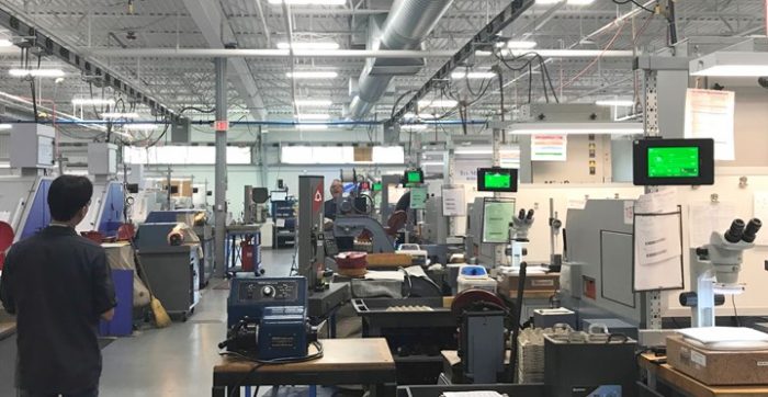

The green screens on these machines represent MachineMetrics’ Operator view in action.
