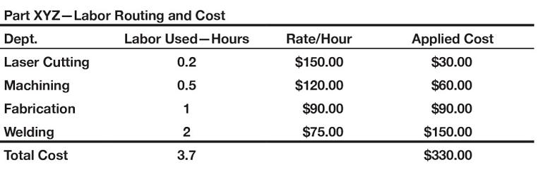

Figure 1 To find the applied cost in activity-based costing, a shop simply takes an hourly rate and multiplies it by the labor hours used. This common method isn’t so common in the smallest of job shops, but for a growing manufacturer, it’s essential.

Steve nodded in agreement. “But there is a way to deal with this. It’s called activity-based costing. Instead of having just one cost center across the entire business, you’d now include many more cost centers tied to each unique process.
“For your business, I could see you grouping each of your fabrication and welding departments into two separate work centers, each with its own costs. This might mean you would have a fully burdened rate—labor plus variable and fixed overhead—of say $65 for welding and $75 for the fabrication and plasma cutting department, just for discussion. The laser cutting and machining center departments might then need to be roughly $150 and $120 per hour, respectively, to cover their unique costs of operation.
“You’d apply these varied costs to a part simply by allocating the amount of time used in each department to a given part or assembly. So if it took, say, 0.2 hour to cut a part on a laser, you’d multiply 0.2 by the burden rate of $150, and get $30. You’d then do this for your other work centers. Here, let me show you.”
Steve took a napkin and wrote out the costing of a simple part routed through laser cutting, machining, fabrication, and welding (see Figure 1).
