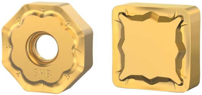

Kennametal has introduced the KCK20B and KCKP10 indexable milling grades for higher wear resistance and up to 30% longer tool life when machining cast iron and compacted graphite iron components. Both grades offer higher productivity and consistent, repeatable performance during roughing, semi-finishing, and finishing operations.
Available for many indexable milling product lines, the new grades come with a golden top layer for fast, easy wear identification, ensuring maximum tool life for each cutting edge.

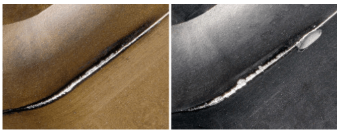

Flank wear comparison: KCK20B on the left and another grade on the right. Flank wear limits tool life when machining cast iron and compacted graphite cast iron. KCK20B and KCKP10 grades provide longer tool life, boosting productivity significantly
