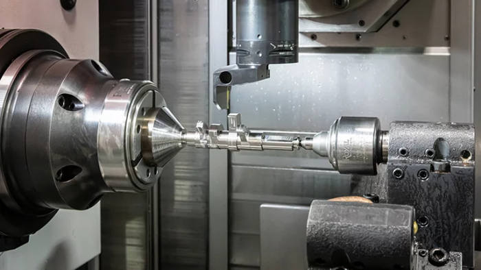

As an example of the parts that Arundel Machine successfully programs with ESPRIT, Hebert pointed to a shaft built for a defense application. The shaft had multiple concave and complex profiles, flat sections, and slots on the end of the shaft. In the past, this part would have been produced in two setups on a CNC lathe, one for each end of the part; three setups on a four-axis machining center to produce the profiles, flat sections, and crosshole; and one setup on a three-axis vertical mill to produce the slot.

Today, Arundel Machine produces the shaft in a single setup by leveraging the NTX 2000 Mill/Turn machine and ESPRIT CAM software. The manufacturing engineer on the job created the CNC program by first importing the solid model provided by the customer into ESPRIT. He oriented the part and then used the CAM software to recognize the features. The software recognized most, but not all, of the 100+ features in the part. The engineer then defined the rest of the features manually by changing the model to wireframe geometry, picking the edges to define each feature one by one and selecting the “Chain” command. In defining roughing toolpaths, the engineer used ESPRIT’s ProfitMilling strategy, which optimizes engagement angle, chip load, lateral cutter force, and machine acceleration to reduce cycle time when cutting out large areas of stock. ProfitTurning was also used for grooving out between the cams. Compared to the traditional turning toolpath, this ESPRIT cycle worked well for breaking chips, resulting in increased removal rates and longer tool life. ESPRIT’s four-axis wrap milling is used for cutting, while the C-axis is rotated to semi-finish and finish machine the cam profiles. Other finishing operations performed with five-axis include contouring and composite cycles.

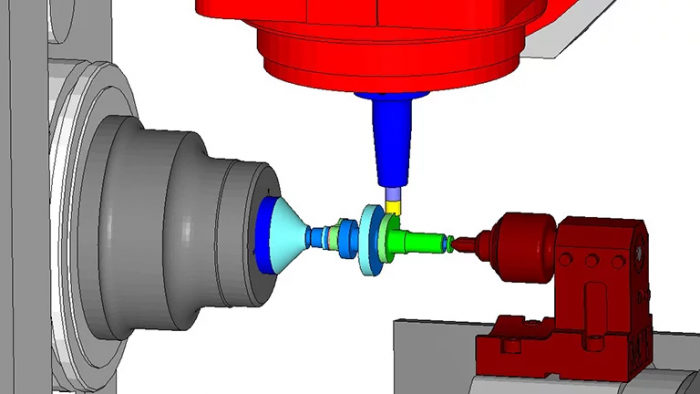

When the engineer was satisfied, he ran a simulation of the machining operation to check for crashes or gouging, inspected the dimensions of the machined part, and looked for opportunities for cycle time improvement. The program worked exactly as simulated on the machine and produced good parts from the first time it was run.
A safety cam shaft programmed in ESPRIT and machined on a DMG MORI NTX 2000 nine-axis mill/turn center.
