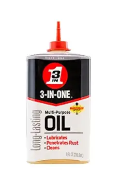

3-IN-ONE Multi-Purpose Oil
Another pretty solid cutting fluid, and it’s been around since the 1800s. Works just as well as a lot of other fancier and more expensive fluids in the market.
Order Now

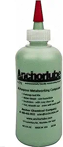

Anchorlube
Anchorlube
Probably the best cutting fluid to operate on Titanium. Just apply a little bit of this magic fluid in the hole and this will prevent your tap from breaking.
Order Now
