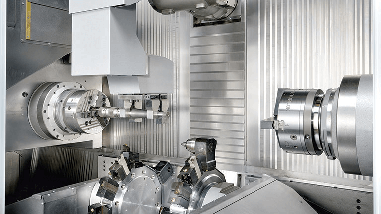

Machining high-temperature alloys calls for stable and powerful machines like the G420 turn mill.

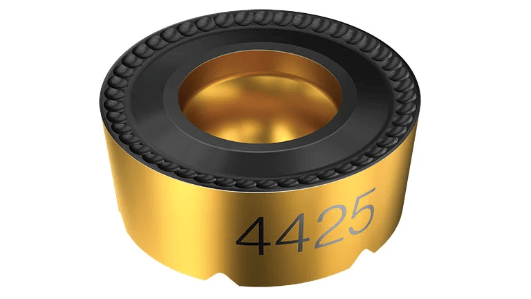

The design of the CoroTurn 107 holds the insert in place when subjected to high machining forces.
Operators “don’t want to be running with their finger on the button all the time waiting to stop the machine,” Lewis said. “They want to be able to run with some consistency and confidence.”

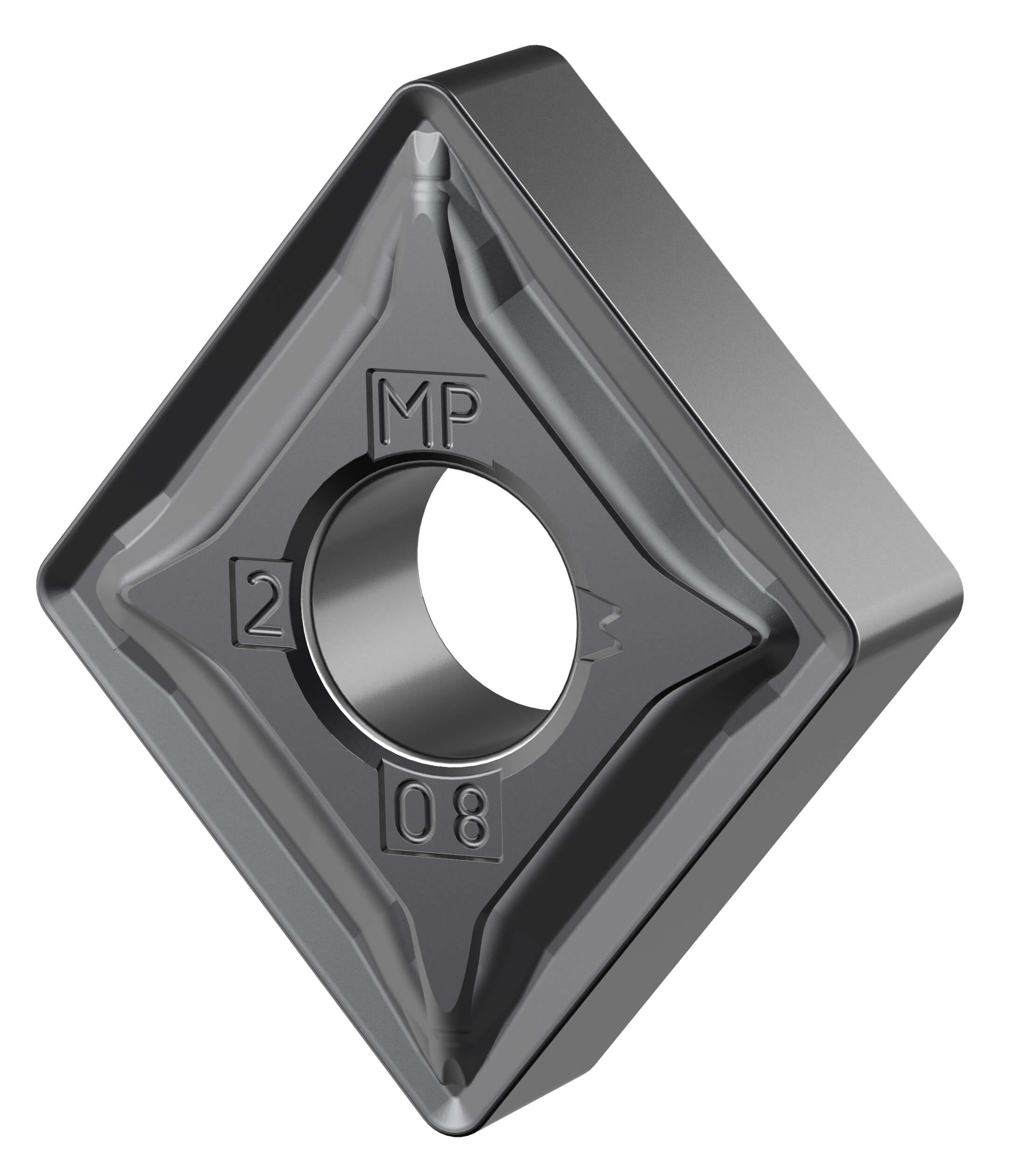

In many cases, he added, operators can complete an entire pass with an insert grade and geometry recommended by Sandvik Coromant, which employs testing and development methods that allow the company to accurately predict how long an insert will last when cutting a particular HRSA.
Besides improving cutting consistency, the right insert geometry, or chip breaker, can give a boost to tool life. “If the chip is hitting and rubbing the cutting edge, that can cause the insert to break down faster,” Lewis explained. “So if you can direct the chip away using the right chip breaker for your application, it will extend the life of your insert edge.” Sandvik Coromant has chip breakers designed for roughing, intermediate and finish machining of HRSAs.

In addition to their inserts, shops cutting HRSAs must make sure their machines are up to the job. Though it’s not good practice to put a part in a machine tool that’s larger than what the machine is designed for, “with steel, aluminum and brass you can get away with it. But with Inconel, that’s a no-no,” said Mark Page, senior applications engineer at Index Corp., Noblesville, Ind. With Inconel and other HRSAs, in fact, “you’re better off having a machine that’s overpowered for what you need.” Machine tool makers offer online calculators that allow users to determine the horsepower and torque required for their applications.
According to Page, machines with high horsepower and torque capabilities also tend to be rigid, which is another important characteristic for machines that cut HRSAs. For increased rigidity, Index offers a patented system called W-serration for machine turrets and toolholders. When a toolholder is inserted in a turret, W shapes cut into the base of the toolholder engage with corresponding shapes cut into the turret, making for a secure, rigid connection.

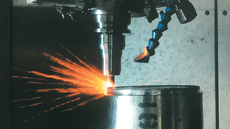

Since heat is a major concern, coolant also becomes particularly important when cutting HRSAs. In these situations, “the more coolant, the better,” said Page. Specifically, he recommends applying plenty of high-pressure or flood coolant to cutting edges during HRSA machining to reduce heat and extend insert life.
Though heat concerns often slow the speed of Inconel machining, speeds can be increased significantly when high-pressure coolant is used, Lewis noted. High-pressure coolant “is probably a standard now with all heat-resistant superalloys,” he said. “If you’re not running a tool with high-pressure coolant, you’re running at a disadvantage.”

Recently, Sandvik Coromant introduced a round insert system for HRSAs featuring high-precision, coolant-through technology. Called CoroTurn 107, it’s also designed to prevent micro-movement or rotation of the insert when cutting forces are high. A shim in the holder engages with a groove in the bottom of the insert to lock the insert in place, Lewis explained. He added that some CoroTurn 107 inserts come with CBN around the periphery for increased productivity when cutting HRSAs.

Ceramics are another effective material option for cutting HRSAs. Ceramic inserts can cut Inconel 718 five to six times faster than their carbide counterparts, according to Page, who added that they are widely used in the aerospace industry for mass material removal.
A number of companies now offer ceramic end mills for cutting HRSAs. One of these is OSG USA Inc., Irving, Texas. The time difference between cutting projects done with carbide and ceramic end mills can be dramatic, according to Jeff Stephens, applications engineering manager at the company. “Roughing out an Inconel part with carbide may take hours, depending on the strategy, whereas roughing out with ceramic tools may take minutes,” he said.
Ceramic is typically very hard and offers good wear resistance compared to carbide, Stephens noted. And heat resistance is what allows ceramic tools to run at extremely high speeds.
Ceramic tools require machines with spindles capable of running up to 30,000 rpm in some cases, Stephens said. They also require a “super-rigid” setup, more so than for carbide tools, he added, including a high-quality rigid toolholder.
Rigidity is important because vibration will destroy an insert made of ceramic, which is very brittle, Page said. So in addition to employing a rigid toolholder, users must make sure the workpiece is securely clamped, particularly for roughing operations. Finishing is a different matter, he noted, because tool pressure is lower than it is during roughing.

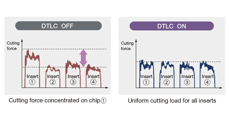

In addition to machine designs that minimize the danger posed by ceramic cutting tools, Okuma offers an optional feature that can be especially helpful to shops that machine HRSAs. Called Dynamic Tool Load Control (DTLC), the technology includes a gage that measures tool runout during cutting. This information goes into an algorithm that dynamically adjusts the feed in accordance with the runout data so the loads on individual inserts are the same as machining proceeds. Evening out insert loads can result in anywhere from two to five times longer tool life, according to Anderson.
DTLC can also prevent unpredicted tool failure that causes both machine downtime and part damage. “The worst-case scenario is scrapping a part that has a lot of time, labor and money put into it because a cutting tool went bad prematurely,” Anderson said. This result, he added, is particularly costly for shops making expensive HRSA parts.

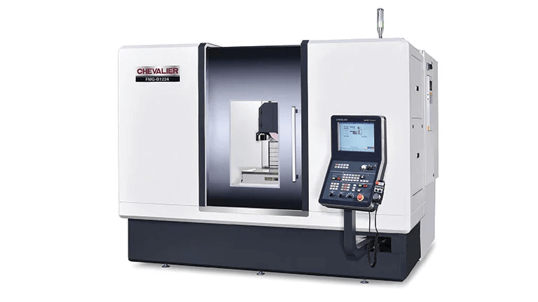

The new FMG-B1224 offers the horsepower and rigidity needed for creep-feed grinding.
Traditional grinders are built for light, fast cuts, Shiu noted. But an alternative method called creep-feed grinding takes heavier cuts and moves more slowly—thus the name. Despite its name, Shiu said, Chevalier has found that creep-feed grinding of materials like Inconel is actually about 50 percent faster than the traditional grinding method.
Shiu added, however, that more horsepower is needed for creep-feed grinding because heavier cuts are being taken. With a 40-hp spindle, Chevalier’s new FMG-B1224 has what it takes to make bigger cuts, he said.
In addition, Shiu pointed out that creep-feed grinding requires a more rigid machine, so the FMG-B1224 design adds rigidity with several new features. One of these is a different casting. The table on a typical grinder hangs off at the end when it travels all the way in one direction or the other because the casting only supports the middle of the machine, Shiu explained. But the casting of the FMG-B1224 supports the table at all times because it extends far enough to support the full travel of the machine.
