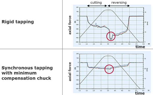

Is rigid tapping being used?
When rigid tapping, the cutting forces can be very high, particularly if tapping very deep threads or machining them at very high sfm.  The torque exerted on the part when reversing, is maximized with rigid tapping.
Using a Synchronous tapping head with minimum compensation will reduce these high tapping torques which cause the tap to break.  Not only does the Synchronous tapping head reduce the overall value of the torque, it also softens the transitions through the different phased of the tapping cycle.  Thereby increasing the overall tool life of the tap.
Using a Synchronous tapping head will greatly reduce the amplitude of the torque being applied to the tap, but also soften the transition points
