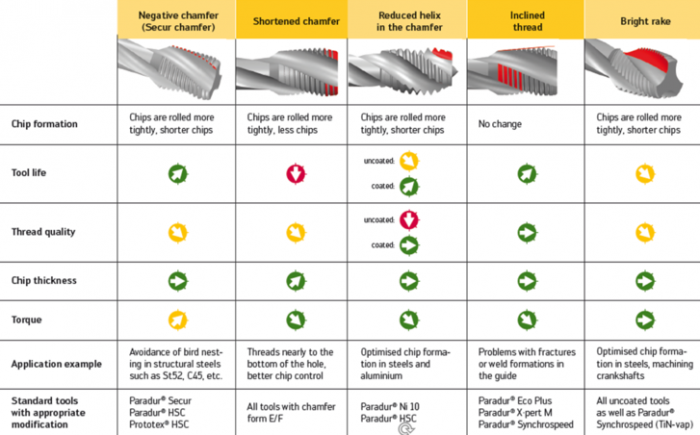

When having problems with chip control, fractures can occur. Loosely wound chips harm the tool, in the flute area, when being evacuated.
The best way to address this problem is by switching to a standard product with one of the below flute features.
Chip formation
Several different features can be added to the tap which affect the way the chips are formed.
If you cannot improve the chip control, it’s generally recommended to switch to thread forming or thread milling.

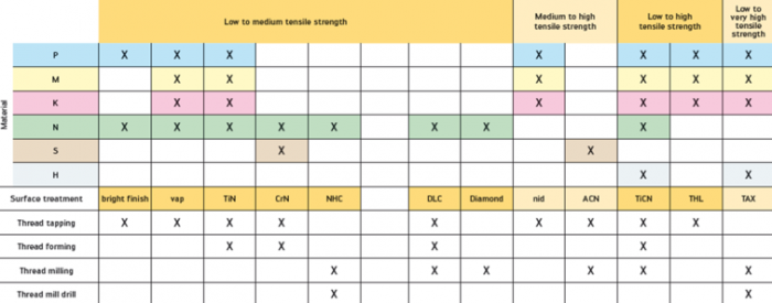

  • Choose the ideal coating for the material.
tool coating
Ensuring that the tool coating has an application range in the material being machined can have a big improvement in tool life.
