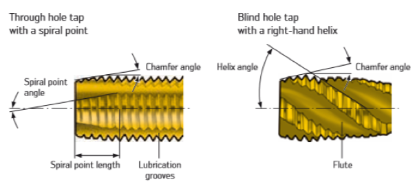

When troubleshooting broken taps, we must first identify where the fracturing is occurring on the tool.  Depending on where we see the fracturing occurring, it will affect the corrective action that needs to be taken.
spiral point tap and spiral flute tap
Anatomy of a spiral point tap and a spiral flute tap

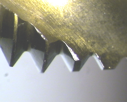

Fractures in the Chamfer Area
fractures in the chamfer area
When the chip gets jammed between the tool and part while reversing, we see fractures in the chamfer area.
Cause
Chips can get jammed between the tool and the base material when the tool is reversed.
It is also possible for chips to get jammed while cutting (this is less common).
Solution
  • Improve the chip control (see the previous article on chip control).
  • Choose a tool with lower relief angle in the chamfer area to avoid the chips getting jammed between tool and component when reversing.
  • Choose a tool with a tougher substrate that will be less likely to fracture if compromised with less than ideal condition such as chips jamming.

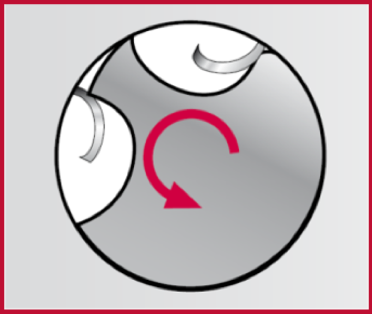

jammed chip
When the tap is reversed, the last chip must be sheared off by the back of the tap land.  If the clearance is too high, the chip can get jammed and break the tap.

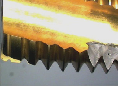

Fractures in the Guidance (non-cutting) Area
fractures in the guidance area
When the chip gets jammed between the tool and cutting teeth, we see fractures in the guidance area.
Cause
Long, stringy and loosely curled chips can get caught by the teeth of the tap.  When this occurs, we see fracturing of the tool behind the chamfer, in the guidance area, which is also the non-cutting area of the tap.
Solution
  • Choose a tool with a tougher substrate that will be less likely to fracture if compromised with less than ideal condition such as producing long stringy chips.
  • Improve chip evacuation by using internal coolant, with axial exit for blind hole applications. Blind hole applications are normally affected the most by poor chip evacuation.
