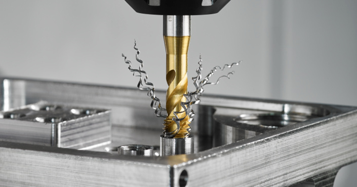

In this post we’ll provide remedies for the issue of when the no-go gage enters the thread. The goal is to offer you suggestions and changes that can be made to increase the quality of the tapped hole. This particular problem typically stems from the issue of the thread pitch diameter being too large and allows the no-go gage to start in the hole. For further information on other issues such as thread quality related issues, go gage does not enter the thread, insufficient tool life, chip control, excessive wear, fractures , chip welding, and tool breakage please see other articles in this series.
When the no-go gage can be threaded into the part, it is considered out of spec and not acceptable. There can be several causes for this that we should look to for correction, such as:

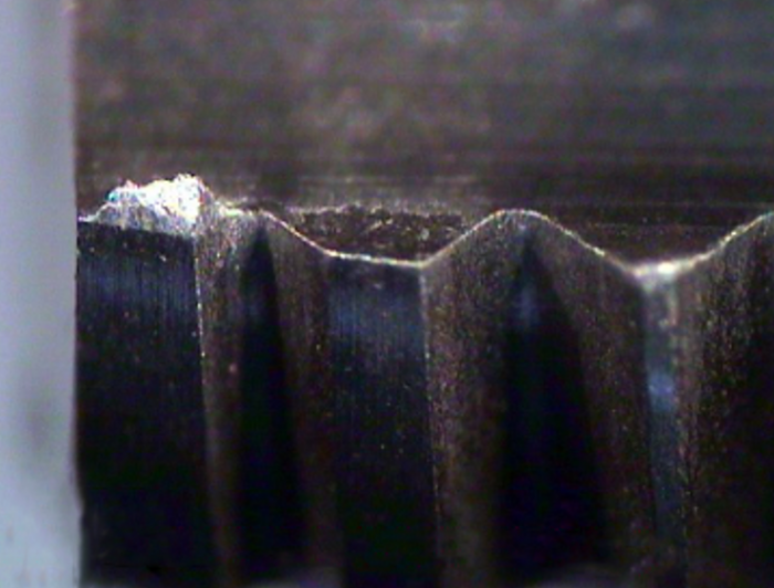

Built up edge
When machining soft or gummy materials, built up edge (BUE) can occur and cause the tap to cut oversized. In these cases, action against the BUE needs to be taken because it will not be possible to cut threads within specification while the material is sticking to the tap.
Built Up Edge (BUE) will cause the tap to cut oversize and allow the No-go gage to start into the part
The surface treatment of the tap may not be appropriate for the material being machined. If non-ferrous material is being machined, uncoated tools or even polished tools are preferred. The sharp, smooth surface makes it more difficult for the material to stick. However, if the material being machined is carbon steel, titanium, or nickel based alloys, the opposite is true. These materials require a coating that is properly specified by the tooling manufacturer. Stainless steels are usually the most common materials for this particular problem, and they of course require a unique solution. Surface treatment of the taps such as a VAP coating or steam oxide are the most preferred. The cutting edge does not get rounded over from having a coating covering it, this would hurt chip control. Yet, it is not left as unprotected compared to having it completely uncoated.
The BUE could also be a sign that the tool is simply worn. Tools that have dulled from abrasive wear generate more heat and do not machine as effectively due to higher cutting forces. In these cases, replace the tool.
Optimizing the coolant supply can have a great effect on preventing the BUE from occurring. Position the coolant lines so that they are flushing the chips as effectively as possible. Sometimes, the coolant is oriented so that it is actually washing the chips back into the hole. Ensure that this is not happening. If internal coolant is not being used, switch to a tap that accommodates internal coolant. The coolant will help with chip control. In all cases of either internal coolant or external coolant, try to maximize the coolant pressure.
