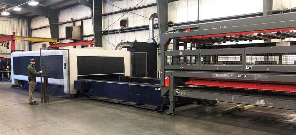

The shop does use automation attached to one of its Bystronic lasers, mainly for scratch-free processing.

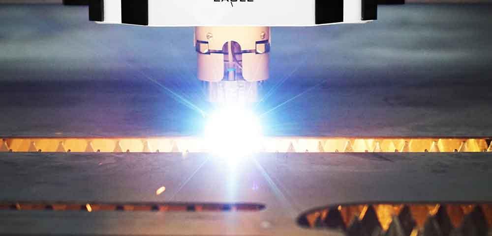

Except for swapping the bottom cover slides, the newest fiber laser heads are sealed and can’t be accessed except by the laser OEM. But that doesn’t stop the fabricator from perfecting the process. For instance, on its 12-kW Eagle fiber laser (sold in the U.S. through Fairmont Machinery), Cupples’ team studied the cut. They knew the beam had the power and focus to make a good cut extremely quickly, but could it be even better? They looked at the nozzle and had a thought.
“We said, ‘Hey, we’ve got machining capability, and we have copper stock. The machine manufacturer is onboard with this, so let’s cut our own nozzle and see what happens,’” Cupples recalled. That nozzle, designed to promote laminar flow and reduce turbulence of the nitrogen assist gas throughout the kerf, sped the cutting speed by about 20%. “The last time I checked, we’ve been cutting 3/8-in. carbon steel at about 305 inches per minute.”
At FABTECH® 2019, that nozzle—informally called the Cupples Nozzle—was on display at the Eagle Laser booth. As Cupples recalled, “The 15-kW machine at the show was cutting 3/8-in. steel at 390 inches a minute with a Cupples Nozzle.”
