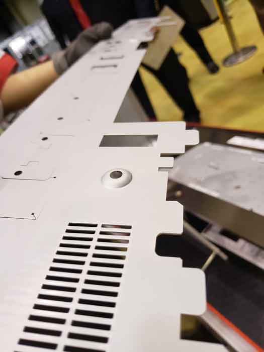

For years many have questioned the future of the punch press, especially after the fiber laser came onto the scene. For many applications the laser head outpaces the punch, even for hole-intensive jobs.
But visit Ometek, a large contract fabrication operation outside Columbus, Ohio, and you’d see the punch press is alive and well, not as a stand-alone operation but as an integral part of the punch/laser combo. The combo, including its two Amada machines with automated loading, unloading, and part removal and stacking, is now central to Ometek’s cutting strategy.

That said, those two lasers still don’t handle the majority of the fabricator’s product mix. Glance at a typical part fabricated by Ometek and it’s easy to see why. Cut blanks have numerous louvers, lances, tapped holes, and countersinks.
“By 2012 we found that we could attain better utilization and run the parts faster if we used a standard turret setup, then laser-cut features [for the tools] we didn’t have,” Mackessy said.
So instead of populating auto-index stations with infrequently used tools, the company found it could cut about 80% of its parts out of a standard set of tools on a turret. The laser could handle the rest. This part mix drove the company to invest in the two Amada punch/laser combo systems it has today, one with a CO2 laser and the other with a fiber laser.

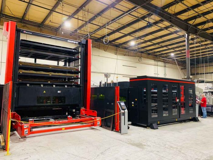

Ometek operates two automated punch/laser machines that produce the majority of the company’s blanks.
About Consistency
The automation surrounding the two punch/laser combos hints at the company’s overall cutting strategy: Primary cutting operations require consistency, and the fewer times cut blanks need to be handled, the better. Sheets are automatically loaded, cut and formed with punch form tools as required. A parts picker removes the pieces from the nest and stacks them, placing them on a conveyor that carries the pieces out of the automated cell.

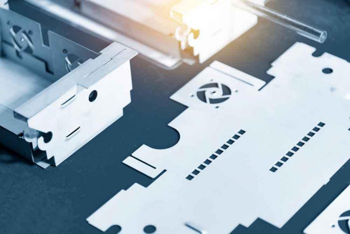

The company’s cutting department took a road that didn’t eliminate the punching operation, though it no longer has any stand-alone turret machines. No matter how quickly a laser cuts, it still cannot form louvers, offsets, flanges, and threads. A combo machine can do all this and more.

Today two people manage Ometek’s entire laser cutting operation. One person runs the cell with two lasers, and another person runs both punch/laser combo systems. The dual laser system runs unattended on nights and weekends as well.

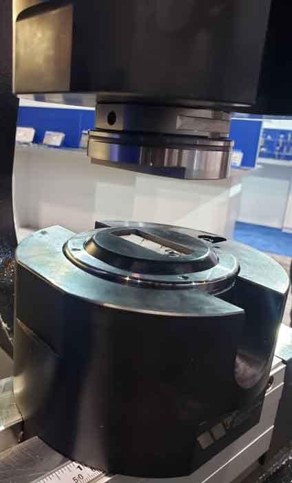

Considering the cutting technology at FABTECH in November, the industry might be at a point of transition when it comes to cutting, and much of it can be summed up by an unassuming tool placed on a mockup press brake at Wilson Tool’s booth. It was a punch form tool modified for and mounted on the press brake.
A Wilson punch tool fitted onto a press brake at FABTECH is designed to act as a forming option for laser-cut blanks or blanks from a punch press with insufficient clearance.
“During the past five years, there has been a huge shift toward lasers,” said Steve Brown, Wilson’s press brake tooling and additive manufacturing product manager. “I can’t tell you how many people I talked with at the show who told me they have no punch presses, but they still need to form.” Rather than job it out, though, a shop can use a modified “punch” form tool on the press brake—a good option for a rarely ordered, low-volume form job.
The existence of the product itself hints at the transition. Fabricators that have shifted away from the punch and toward the laser are now looking at the punch again. Considering the cutting flexibility of the laser and the forming capabilities of the punch, along with the available automation, the punch/laser combo starts to make a world of sense, at least for some shops.
A laser can cut, but it still can’t form.
