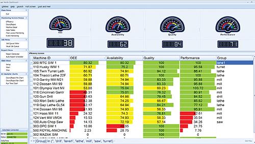

Mazak has adopted the MERLIN machine monitoring software dev…oards, like this one, presented on the flat-screen displays.
Mazak has adopted the MERLIN machine monitoring software developed by Memex Automation. This software automatically organizes the incoming data in a variety of reports tailored for the needs of different users. The software also creates the machine dashboards, like this one, presented on the flat-screen displays.
