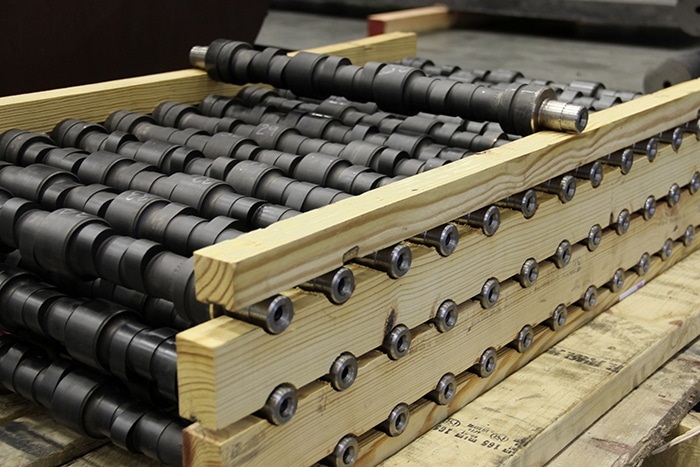

As a result, technology that was developed years ago for high-performance vehicles is now becoming mainstream. For example, sodium filled valves, which formerly were used in only extremely high-performance engines to manage heat in the valve train, are becoming more common. The same goes with hollow camshafts, which reduce energy-consuming rotational inertia and provide opportunities for engine management.

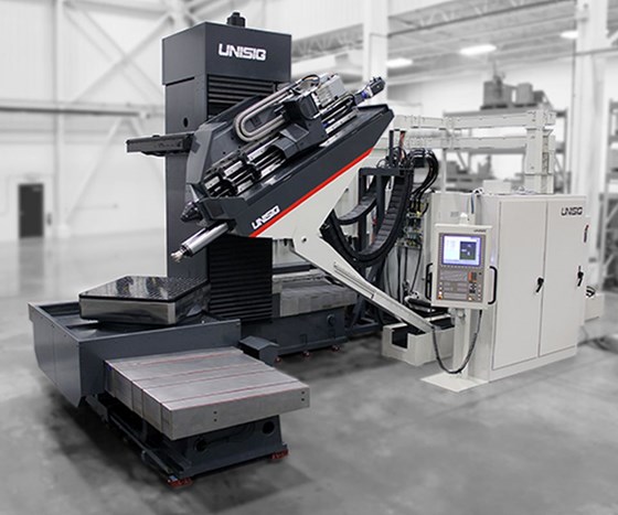

Instead of having a gang of four spindles on a deep hole drilling system pounding out parts, a two-spindle configuration with a rotary table and X-Y positioning system can provide extremely high spindle utilization along with much needed flexibility for automotive manufacturers. (All images provided by UNISIG)

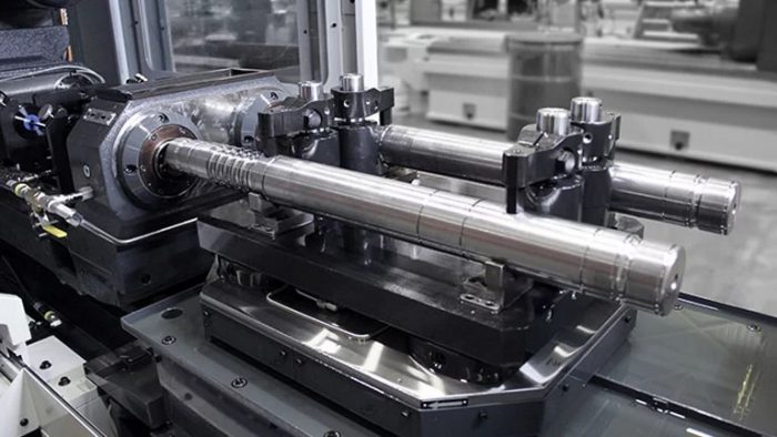

Deep hole drilling is one advanced manufacturing technology that allows for the cost-effective production of key features of those performance-boosting parts. Sodium-filled valves, for example, have holes drilled the length of the valve stem in which liquid sodium circulates and draws heat from the valve head. Precise deep hole drilling methods enable hollow and more energy-efficient camshafts to be manufactured. Complex multi-speed transmissions feature shafts with multiple off-center holes of varying depths for lubrication or hydraulic sequencing. The holes in the shafts are too deep to produce effectively on machining centers, so deep hole drilling machines are critical in those instances.

Automotive OEMs look to reduce energy-consuming rotational inertia with the incorporation of hollow camshafts, made so on deep hole drilling systems.
Consequently, flexibility and spindle utilization have become the main drivers of deep hole drilling machine design. Instead of having a gang of four spindles pounding out parts, a two-spindle machine with a rotary table and X-Y positioning system can provide extremely high spindle utilization along with flexibility. Technology such as automated setup through servo motion to reduce changeover time is also considered in the early concept development of the machines. These systems allow manufacturers to plan and implement small, agile cells to replace large, old-school, high-volume systems.

A recent customer experienced significant benefits with UNISIG’s machine and fixture design. Previously, the customer was processing a challenging family of parts on a system that involved nearly 20 fixtures. Each part required multiple holes with varying depths and diameters. A bulky, dedicated machine created an unnecessary expense and bottleneck in their production.
UNISIG provided a machine that allowed the company to manage deep hole drilling of these parts with just two pallet-changeout type fixtures, and requiring only the selection of a new part program. By eliminating fixturing, setup, and programming time, the company experiences significant savings every time the machine runs.

Today’s highly flexible deep hole drilling systems, such as this one from UNISIG, allow auto manufacturers to plan and implement small, agile cells to replace large, old-school, high-volume systems.
