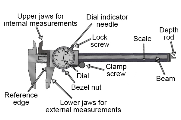

Dial calipers explained
In extremely simple terms, dial calipers are like Vernier calipers with a dial. They use a rack and pinion mechanism to transfer the linear movement of the jaws of the caliper to the rotary motion of the dial indicator.

How to read a dial caliper
Reading a dial caliper is fairly easy and somewhat similar to reading a Vernier caliper. All you have to do is follow these steps:
1. Close the jaws and check that the indicator points to “0” on the dial face.
2. If caliper doesn’t zero, loosen the bezel clamp screw and rotate the bezel to the “0” position.
3. Tighten the bezel clamp screw to fix the “0” position.
4. Close the jaws on the part without applying excessive pressure.
5. Read the measurement.
The main scale on the caliper with the inch system is marked every .100” and represents one revolution. Each graduation on the dial represents  .001″.
