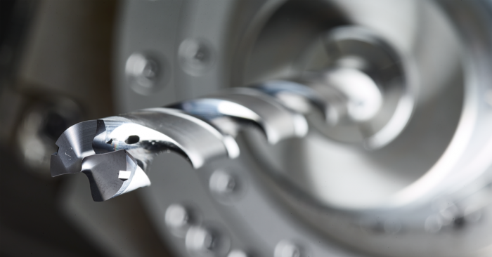

Chip flow
This is one of the biggest headaches with any drilling operation and is the main reason why pecking is so often needed with HSS drills. Without good chip flow, your drill is likely to end up as a melted blob of expensive metal and your workpiece in the scrap bin. Look for a replaceable tip drill with polished, almost mirror-like flutes, and extra-large gullets to eliminate any potential for chip packing, no matter what material you’re drilling.
KenTIP FS features ultra-high polished flutes to ensure chip flow.

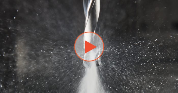

Coolant holes
Generous chip space is meaningless without equally generous application of cutting fluid. If possible, find a drill with two coolant holes per flute. When combined with a high-pressure coolant system (which any smart shop has these days), chip evacuation is assured, tool life improved, and penetration rates substantially increased.
It might seem obvious, but applying coolant through the tool—preferably at 1000 psi or greater—is a critical first step in improving your drilling operations. KenTIP FS has 4 coolant exits. The drill point has 2, and the 2 additional coolant exits in the chip flutes, delivering coolant to the rake face.

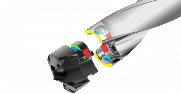

Robust interface
Let’s face it, modular and indexable tools with their tiny screws and awkward placement can be a hassle to work with. Worse, modular drills have gained—in some cases—a bad reputation for the tip working itself loose at the worst possible time. The best modular drills have a taper interface with large contact surfaces and a no-fail locking mechanism, one that’s both rigid and easy to change.
The KenTIP FS coupling is completely protected from chip flow and contact with workpiece

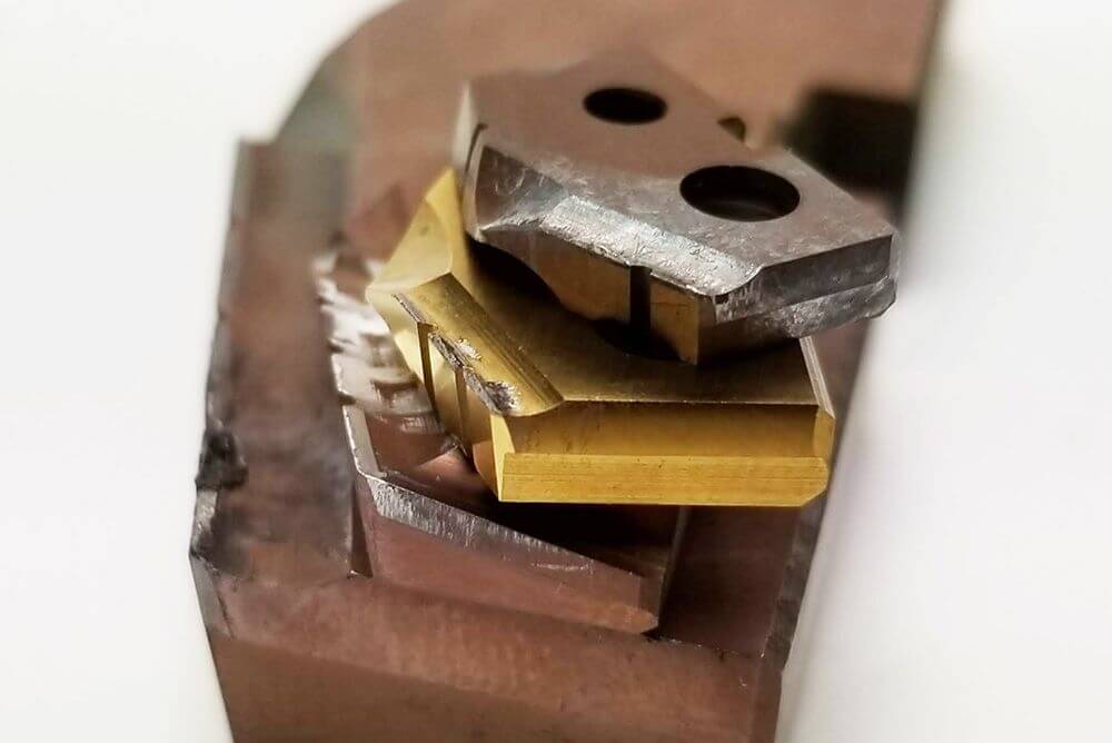

Grade selection
Unless your shop only machines mild steel all day, you’ll need a drill with a variety of carbide grades and coatings, as well as material class-specific point geometries designed for alloy steels, stainless steels and superalloys, and short-chipping metals like cast iron. This assures maximum tool life and hole quality and provides the lowest cost per hole possible.

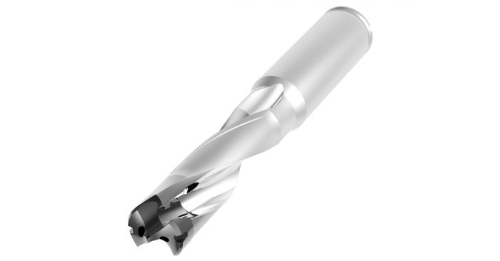

Cost
A solid carbide tool’s higher investment cost is usually the sticking point for most shops and is why many prefer their tried and true HSS drills, regardless of any performance sacrifices. This is the beauty of replaceable tip drills. They are much less expensive than solid carbide, are available in a similar size range and there’s no more worry over reconditioning—when the tip has reached its end of life, just pop on a new one and recycle the old.
KenTIP FS modular dills are available from 6mm on.
That’s not to say that solid carbide drills don’t have their place—they do, and are often the only option in extremely demanding applications—but thanks to their lower initial cost and nearly equivalent performance, a replaceable tip drill should be the first choice whenever possible.
