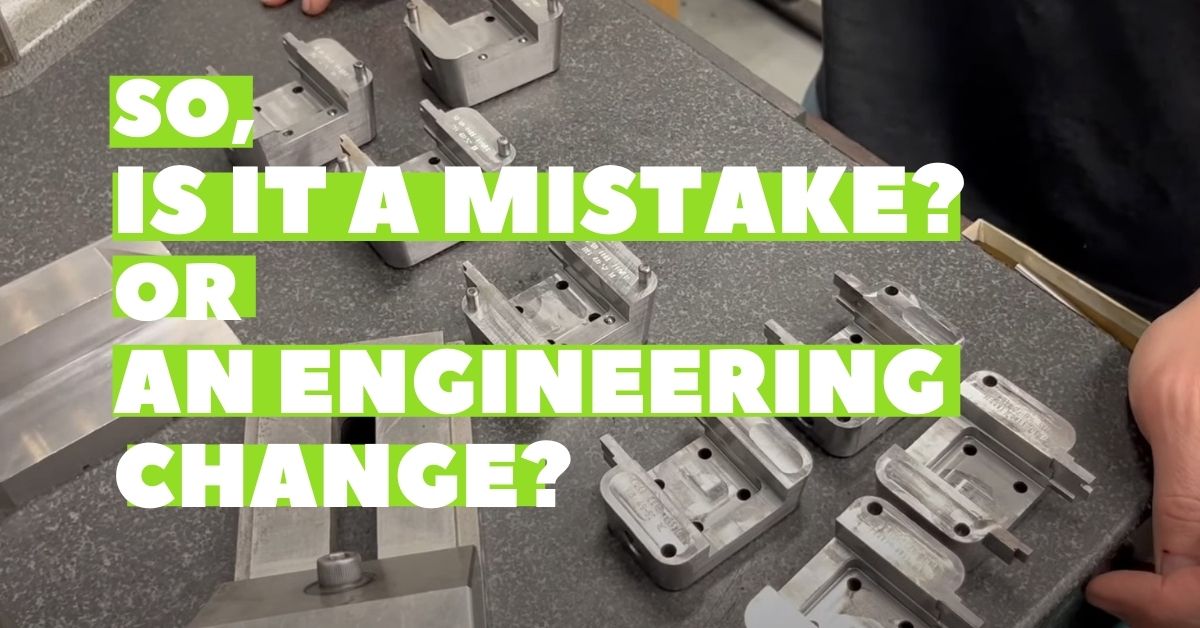

Is there such thing as zero tolerance? 3 levels of tolerancing and Steve’s method to all the madness will be explained in this video.
Here are the following topics that will be covered in this video:
  • The three different levels of tolerancing
  • Part print tolerancing
  • Working tolerance
  • Fit to / shut off tolerancing
  • An example of the shut off tolerancing
  • Testing hole tolerancing with pins and different types of pin fits.
  • Tips for sinker EDM tolerancing
  • Gate insert with invisible seams
