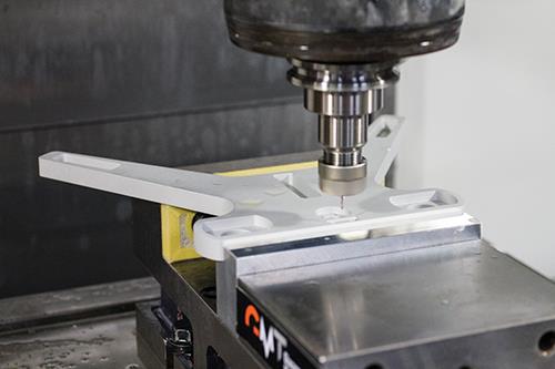

Maybe yes. The challenge was to do this in a way that was cost- and time-efficient. Fixturing was not the answer. Creating precise, sophisticated holding fixtures to quickly and accurately clamp every one of these parts would make no sense, because there are more than 100 part numbers per kit, most of which are produced in quantities of only 50 before the racing season ends and new designs are developed. The fixtures would be discarded too quickly.
The answer Aerodine found instead lets the company rely on less sophisticated fixtures that are easier to discard. The company makes inexpensive tooling out of RenShape modeling board—fixtures that do little more than support the part. The tooling doesn’t don’t need to precisely position the part, because Aerodine relies on probing, not exact physical positioning during setup, to achieve the necessary precision.
Specifically, the company uses the “PartAligner” feature of Delcam’s PowerInspect software to precisely rotate a machining program’s XYZ coordinate system to match the orientation of the workpiece as determined from the probing measurements. The machining program created in PowerMill (also from Delcam) is then re-posted to match the coordinate system based on the actual measured position of the part.
In other words, the CFRP part’s precise location and orientation now do not matter. Aerodine’s system adapts the machining program to find the part. The question of saving setup time is no longer important, because setup has become a quick and easy step.

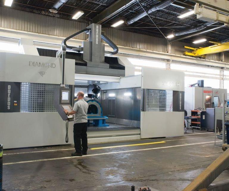

Company machining manager Kyle Castor oversees and programs the router, and he performs this setup—or lack thereof. For each aero kit part machined, he bolts a vise to the table, clamps the RenShape fixture in the vise and places the workpiece into position on this tool without any need for minute, careful adjustment of vise, fixture or part. The setup is simple, but the reason it is simple lies in the measures he has taken long before this moment. For each part, Mr. Castor has devised a probing routine with sufficient measurements to capture that part’s precise location and orientation. Quickly running that probing routine is therefore the final step each setup requires. The PowerInspect software mathematically fits the probe measurements to the part’s CAD model in order to locate the part in space.
Mr. Castor recognizes his company’s parts are particularly good candidates for this probe-and-align approach to setup. The parts here frequently lack straight lines, and they have short product lives. Even so, he says it surprises him that this method of locating the part is not used more pervasively. In this application at Aerodine, the shop has discovered that software can almost entirely take the place of the steps that traditional part setup requires.

The steps of his setup of a CFRP part on the router now come down to this: He affixes the vise and fixture as described above (and perhaps the workpiece as well—read on). No measurements are made at this point, and no attempt is made to finely adjust their position. At the CNC, he has the router load the Renishaw spindle-mounted probe and he runs the probing routine for that part. In some cases the fixture is probed, and in some cases the part is probed (depending on the part number in question). Once this probing is done, he returns to his desk just outside the shop, where he applies the measurement data within PartAligner to discover the necessary rotation angles for the coordinate system to match the part’s orientation. He applies this new coordinate system to that part’s program within PowerMill and posts out a new program updated accordingly. Every workpiece thus gets its own uniquely posted program, fitted to that part’s location and orientation.
This entire process takes fewer than 10 minutes per part. The ease of setup is comparable to the time that was formerly required to mount a drilling and trimming jig back when these operations were manual.
