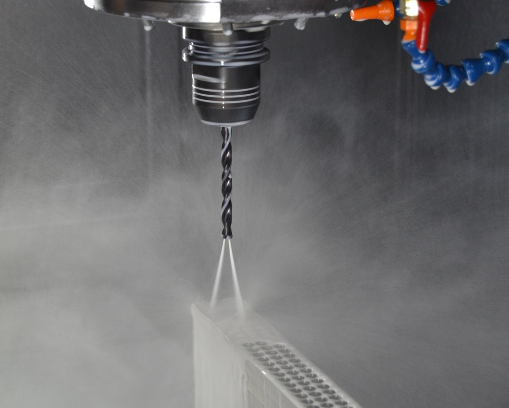

Coolant:
A generous flow of cutting fluid removes heat from the chip, helps chip breaking and at the same time, improves dimensional stability of the component. Cutting tools with through coolant provide instant cooling at the cutting interface, which also helps chip breaking and evacuation.
When using flood coolant, always ensure a plentiful supply, as any period of coolant starvation can cause temperature fluctuations. This, in turn, can cause thermal cracking, resulting in reduced tool life. Neat cutting oils work very well but, if using an emulsion, an eight to ten per cent concentration is recommended.

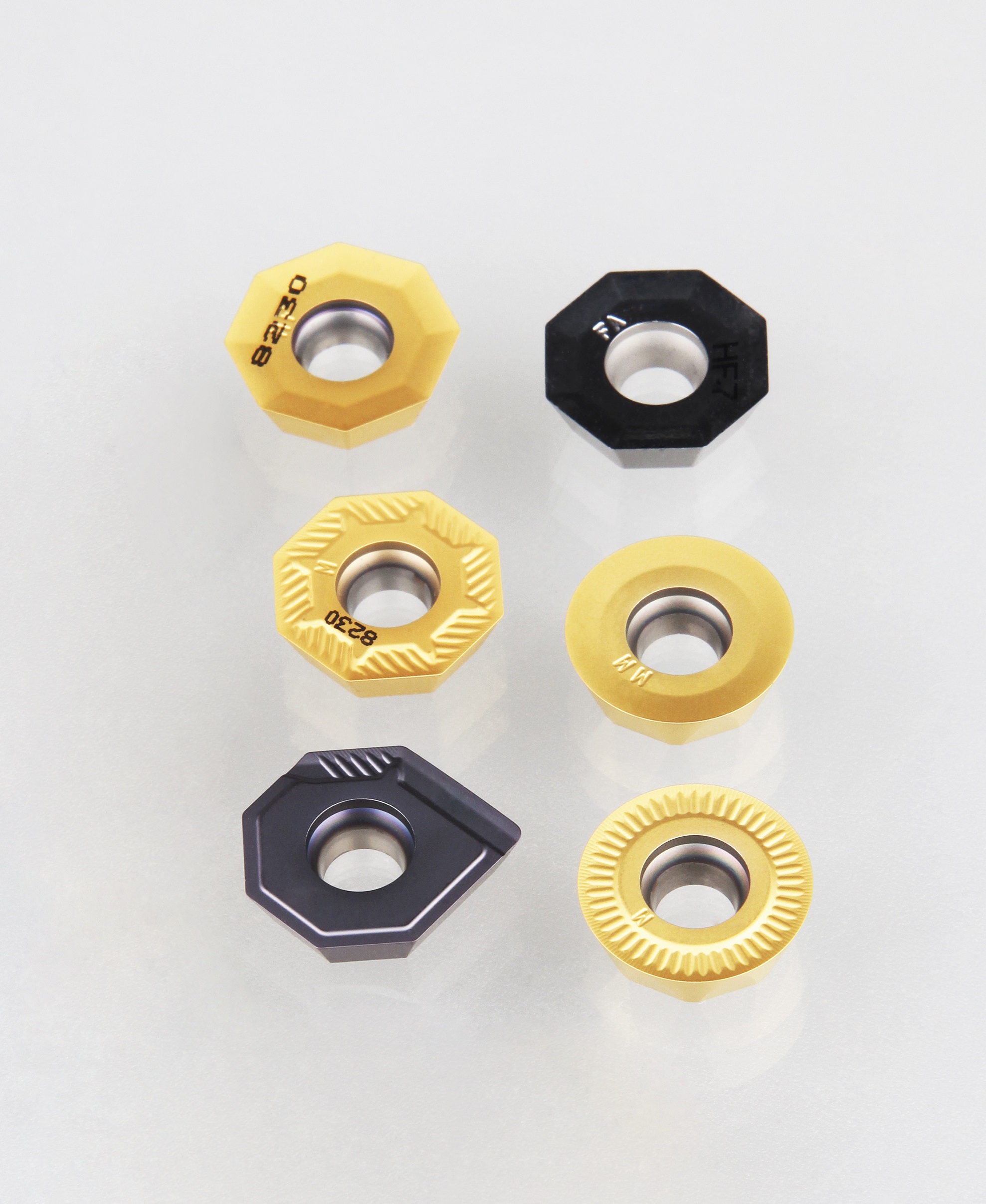

The Pramet M6330 grade was specifically designed to achieve longer cutting edge durability and reliability in stainless steels with and without coolant. Particularly suited to adverse cutting conditions, it promotes greater operational reliability and tool life, with a high resistance to heat-related cracks due to improved abrasion resistance from a new substrate and PVD coating.
