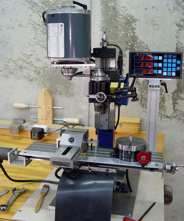

DROs are compatible with many different machines, most commonly mills and lathes. On a milling machine, a 3-axis DRO shows the X and Y axis positions of the mill table plus the Z axis position of the cutting tool. On a lathe, a typical 2-axis DRO shows the carriage and cross slide positions.

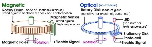

Each encoder comes in a variety of different types. The most common being optical and magnetic encoders.

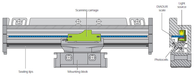

Optical
A glass scale is a thick glass strip with two optical sensors that are positioned close together to execute some form of photoelectronic scanning. Essentially, optical scales use either the reflection or diffraction of light to sense positioning. The strip is cradled in an enclosed aluminum housing. The housing is a vital protective measure, in that optical encoders are highly sensitive to any debris that could interfere with the transmission of light and are positioned directly where the work is performed.
Glass scales are the best for ultra-precision machining because they offer higher resolution than their magnetic counterparts. This makes them very popular in aerospace manufacturing.
If an optical model is what works for you, here’s a recommendation.
Magnetic
Magnetic encoders have sensors that provide position information by detecting change in magnetic fields. If your application requires a long encoder, magnetic encoders are offered in lengths up to 100 meters. The bulkiness of magnetic style encoders does make the mounting process a bit more difficult, however their design style allows them to be so robust.

    Selected magnetic because I don’t like glass in my shop. DROPros absolutely finest, workmanship, tutorial first rate! 2 axis for the mill [came with a quill DRO], and 2 axis for the lathe. GREAT FUN installing, tutorial step by step on YouTube. If I can do it any of you can do it! Dr. Robert Beeman
