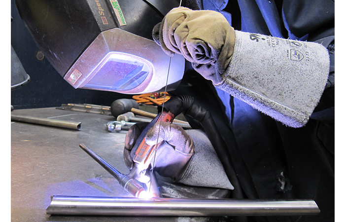

For precision welding requirements, the choice is usually between electron beam welding and laser beam welding. Sometimes other types of fusion welding, such as GMAW or GTAW, might be an option, but arc welding processes don’t have the penetration, small heat-affected area, pinpoint precision, and weld purity of EB and laser welding. Electron beams and lasers can be focused and aimed with the exceptional accuracy required to weld the smallest of implantable medical devices, and yet also deliver the tremendous amounts of power required to weld large spacecraft parts. Electron beam and laser welding are versatile, powerful, automatable processes. Both can create beautiful welds from a metallurgic and an aesthetic perspective. Both can be cost-effective.

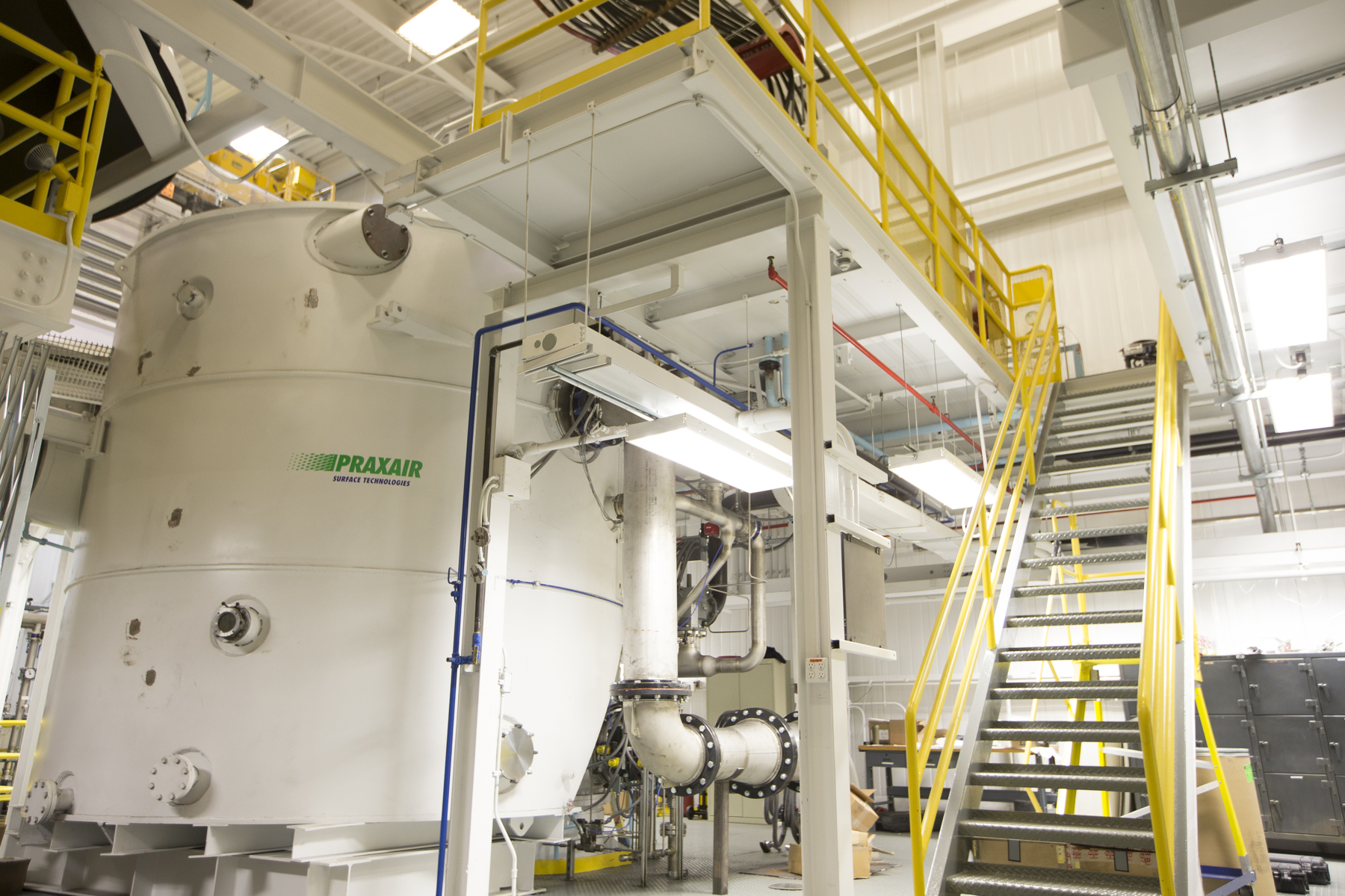

The logistics of operating an EB welding system aren’t simple, however. The process has to happen in a vacuum; otherwise, air/gas particles scatter and diffuse the electrons. A vacuum requires a vacuum chamber, so the size of a part to be welded is limited by the size of the chamber. Vacuum chambers can be small or large, but the larger the chamber, the longer it will take to establish the proper vacuum level, which is at a minimum 1.0 x 10-3 torr. The use of a vacuum, as well as the presence of X-radiation (a byproduct of the beam), precludes human handling, so the entire process has to be externally controlled, generally using CNC tables.

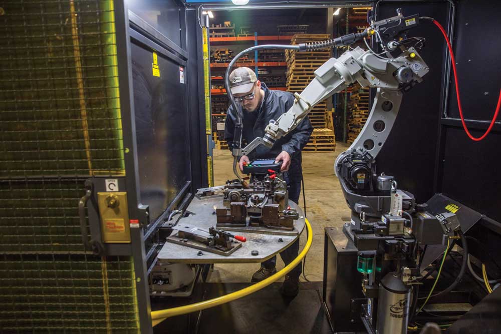

EB welding is a fusion welding process and thus requires a precise fit between the parts being welded, as a filler material is generally not used or required. The parts must also be securely fixtured to a motion-controlled table to precisely move the areas to be welded into contact with the electron beam. Most EB welding machines utilize a fixed beam with the part being manipulated under it via CNC.
Secure fixturing also minimizes the effects of shrinkage and warping during welding. The electron beam has to be carefully calibrated and focused and timed with the CNC motion to deliver a consistent weld with uniform penetration and minimal porosity. Each welding cycle involves loading the welding chamber, pumping down the vacuum, welding the part, and then venting the vacuum.

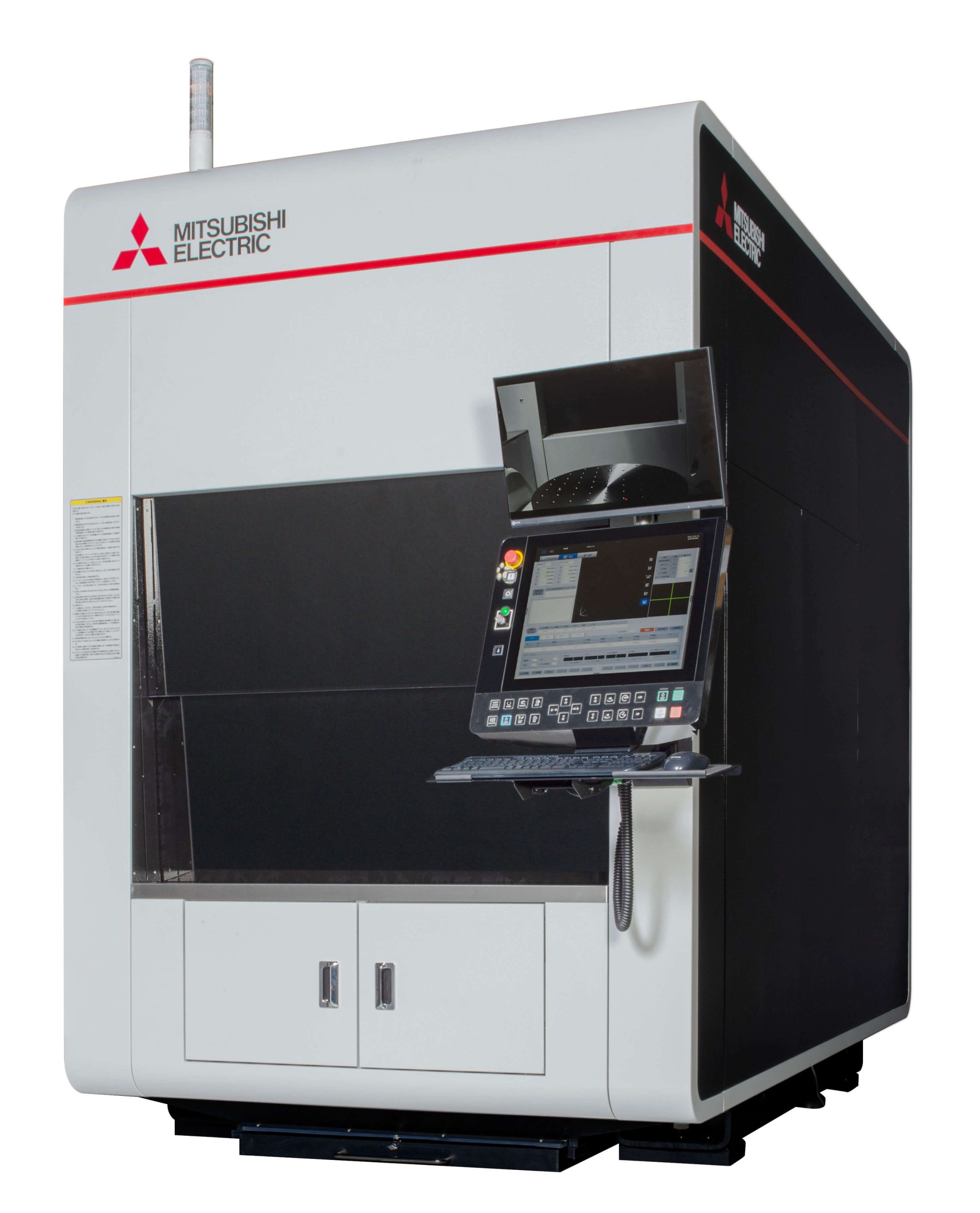

Laser Beam Welding
Lasers were developed in the early 1960s, and by the mid-1960s CO2 lasers were being used to weld. A decade later automated lasers were welding on production lines, and the technology has continued to improve and find wide acceptance in many industries.
A laser welding system is capable of delivering a tremendous amount of energy very quickly and with pinpoint accuracy. The beam can be focused and reflected to target hard-to-access welds, and it can be sent down a fiber-optic cable to provide even more control and versatility.
Lasers basically work by rapidly raising and lowering the energy state of a material, which causes the emission of photons. How this occurs depends on the type of laser, be it a CO2 or solid-state system like Nd:YAG or fiber laser.
Regardless of how the photons are produced, they’re concentrated and made coherent (lined up in phase with each other) and then projected. When the photons are focused on the surface of a part, radiant heat melts the material in the heat-affected area and travels down through the part via conduction.
This means of applying heat is very different than that of EB welding. The power output of a laser can vary from a few watts to hundreds of kilowatts, and different types of lasers have different welding characteristics.
Laser welding generally requires the use of a cover gas to keep oxygen out of the weld area and improve efficiency and weld purity. The type of gas used depends on the type of laser, the material being welded, and the particular application. Some laser welding applications, such as hermetic sealing, require the use of a sealed glove box to provide a completely controlled environment. Over the past few years work has been done with laser welding in a vacuum. This method has yielded interesting results but has not yet been widely accepted in the industry.
One challenge with laser welding involves reflectivity. Many materials have a propensity to reflect some of the laser beam’s light (and energy) away from the part and the joint, especially as the material melts and becomes more mirror-like. This can minimize penetration and damage material in the vicinity of the weld joint.
To overcome this problem, the laser can be pulsed, or have its energy varied to “break” the surface. Pulsing in general is a useful method of laser welding because the amount of heat applied to the part is minimized, which limits part deformation. The alternative to pulsing is continuous wave (CW). As the name implies, CW lasers utilize a laser beam that is on continuously.
CW lasers are useful for cutting applications or when weld speed is important. For example, an automated GTAW machine might have a welding speed of 10 inches per minute (IPM), while a CW laser could easily run at 100 IPM.
Laser beam welding can achieve good penetration, typically up to about 0.040 in. deep in steel for a typical 350-watt laser. Laser welding can usually join crack-prone materials, such as certain types of steel and aluminum, and much like EB welding, lasers can join dissimilar materials.
Lasers are adept at applying the minimal amount of heat to a part, which makes them a good choice for welding electronics packages, particularly those that are hermetically sealed. Minimal heat means the weld can occur extremely close to sensitive electronic components and solder joints without damaging them. Lasers are also popular for medical device applications as the welds can be quite small with minimal discoloration of the part, and often the weld can be applied without the need for any secondary machining.
