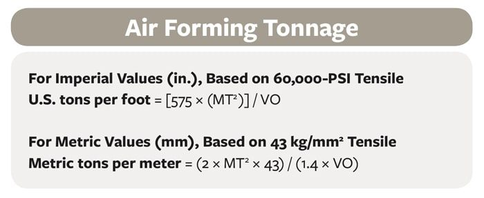

What should be on this cheat sheet depends on the shop and the product mix. Generally speaking, it should describe the basics of forming tonnages to ensure the job can be bent safely with the shop’s available tools and equipment.

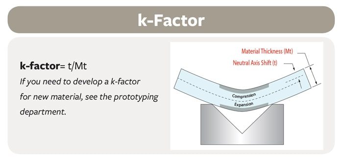

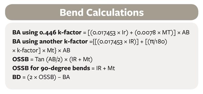

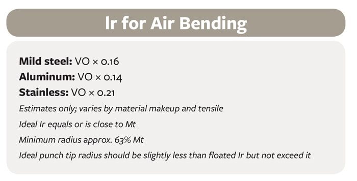

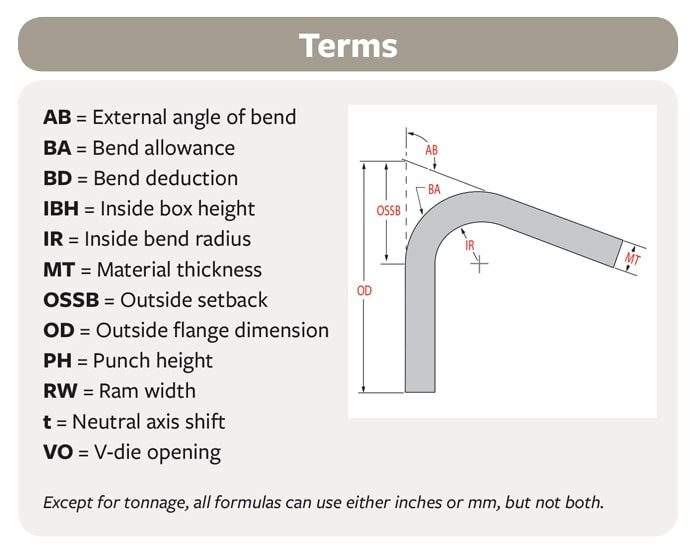

It also should describe the basics of bend allowances, bend deductions, and blank sizes, and how changing the inside bend radius affects all three. It should note whether the brakes are bottoming or air bending. Most modern operations air-bend, so if the shop is still relying on old charts developed around bottoming, operators in the brake department will continue to struggle, often just “making it work” the best they can.
In air bending (or air forming), the die width determines the inside bend radius, not the punch tip. In 60-KSI carbon steel, the radius air-forms at approximately 16 percent of the die opening. That percentage gets larger or smaller depending on the material and its tensile strength.
In most situations the most stable inside bend radius should equal or be very close to the material thickness. Ideally, the punch tip radius should be close to, but not greater than, the naturally floated inside radius. If the punch tip is larger than the inside bend radius, then the bend will assume the new, larger radius of the punch tip, which in turn will change your bend calculations.
For accurate bend calculations, an air-bent radius cannot be smaller than a certain percentage of the material thickness—usually around 63 percent (though there are more exact ways to calculate this). Less than that, and the bend creases and turns sharp. If you have a drawing that calls for an inside radius less than sharp, and if you use that tiny radius in your bend calculations, you’ll create inaccuracies in bending that operators will have to muddle through.

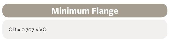

The cheat sheet also should include minimum flange lengths, which usually can’t be less than 70 percent of the standard die width. Ideally, an engineer should look at a flange on a drawing, refer to the tooling library, and know whether it will work with the machines and tools the fabricator has on the floor.

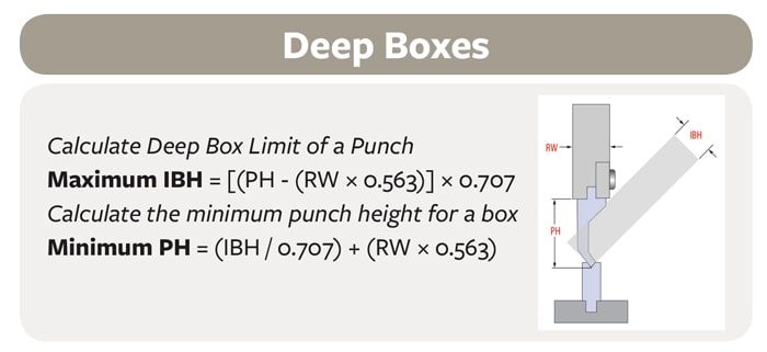

Holes and cutouts need to be factored in as well. Bends near holes or other cutouts cause distortion, so if a design has a bend line at or very near a hole, you could run into problems. Here, special tooling, like rotational wing dies that support the workpiece throughout the bend, can help. Again, the engineer would know if the shop had a rotational die, because he’d have a list of available tools on hand.
He’d also know the tooling shut heights and how they affect bend line access, such as deep box bends with return flanges. The engineer might have to talk with the programmer or others to discuss forming options, be it using gooseneck punches, window punches, a punch with horns, or anything else. But a cheat sheet could at least spell out general guidelines; if the part has flange dimensions outside these limits, the engineer can talk to the programmer to discuss options.

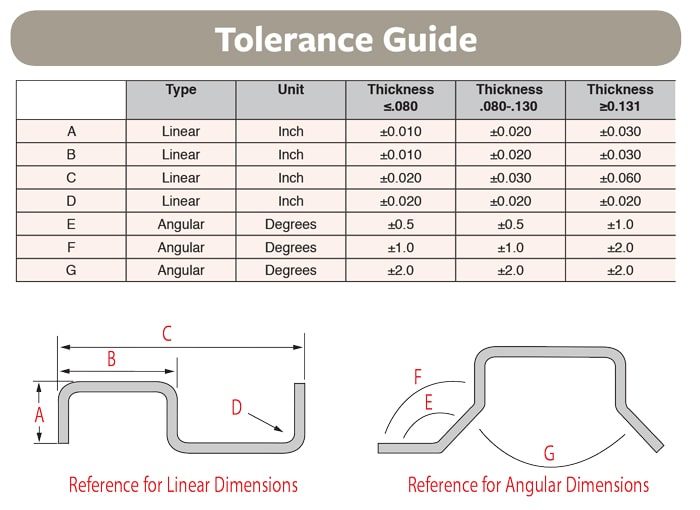

Finally, you have the tolerance guidelines. A cheat sheet should include what the shop deems to be reasonable linear and angular tolerances—that is, those that can be met on any properly set up machine in the shop. Material thickness can vary from lot to lot, and for efficient operation the tolerances specified should take that thickness variation into account.
For precision work, a seemingly small variation in thickness can snowball into major headaches in front of the press brake. But does the work need to be that precise? Do the tolerances need to be that tight? Ideally, engineers should ask these questions from the get-go.
True, a new press brake with modern punches and dies can hold some impressively tight tolerances, but you still need to take that material variability into account. Dealing with that adds costs and makes life in the press brake department more difficult. If a part doesn’t need to be toleranced so tightly, why specify it?

What follows is a hypothetical cheat sheet an engineering department might use for bending. In reality, what exactly to include depends on shop practices, bending technology, material, and the product mix. In this shop, for instance, we’re assuming that the bending department performs air bending only, not bottoming or coining.
Engineers probably won’t use all these formulas. For example, these days software takes care of most bend calculations using time-tested k-factor values. But the formulas show how the inside bend radius (Ir) fits into the larger picture. Change the Ir, and you change everything.
