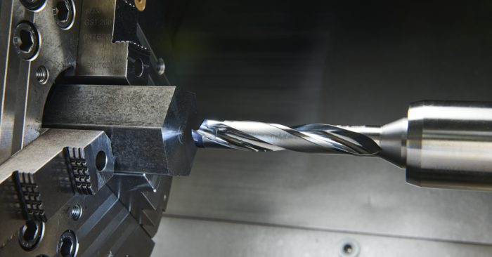

Kennametal was invited by one of its customers to see what could be done to decrease tool costs when drilling a series of 10.5 mm (0.413 in.) holes just 5 mm (0.196 in.) deep in GG25, a type of gray cast iron. Not a big challenge, except the parts were being machined on a 30-taper, 3.7 kW (5.5 hp) drill/tap center, not exactly the most powerful or rigid machine around.
Still, at 5000 holes between sharpenings, tool life was already impressive on the solid carbide drill. KenTIP FS, however, made it better. Using the existing feed rate of 0.3 mm/rev (0.012 in.), the cutting speed was raised from 134 m/min (439 sfm) to 150 m/min (492 sfm), a mere 12% increase. But between that and the extreme performance that KenTIP FS brings to the table, tool life nearly doubled to 9100 holes per edge. As the customer reported:
“by switching to a replaceable tip drill, we saw tool life increase by 82%, and we saved 15 minutes on tool changes.”
If solid carbide drills produced more parts at the end of the day, they would be worth the additional expense, but in this instance and many others, modular drilling tools, such as KenTIP FS, drill more holes while cutting cost.
From 5,000 to 9,100 holes per cutting edge: Modular drill KenTIP FS.
