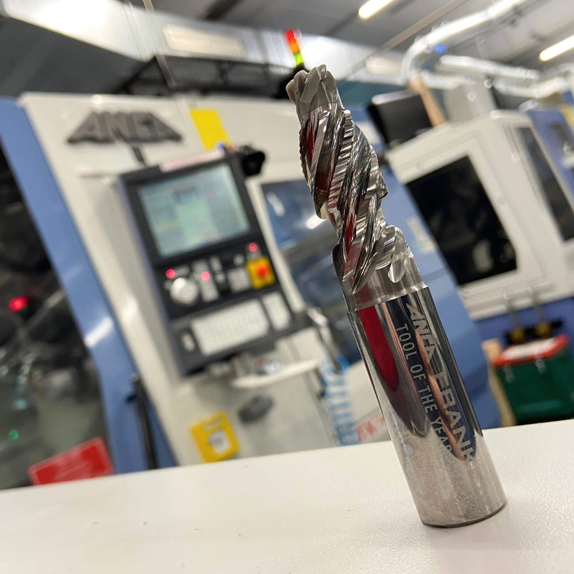

  • EMUGE-FRANKEN, a renowned German cutting tool manufacturer, took first prize for their multi-functional carbide tool infused with ceramic material, promising extended tool life and unparalleled performance.

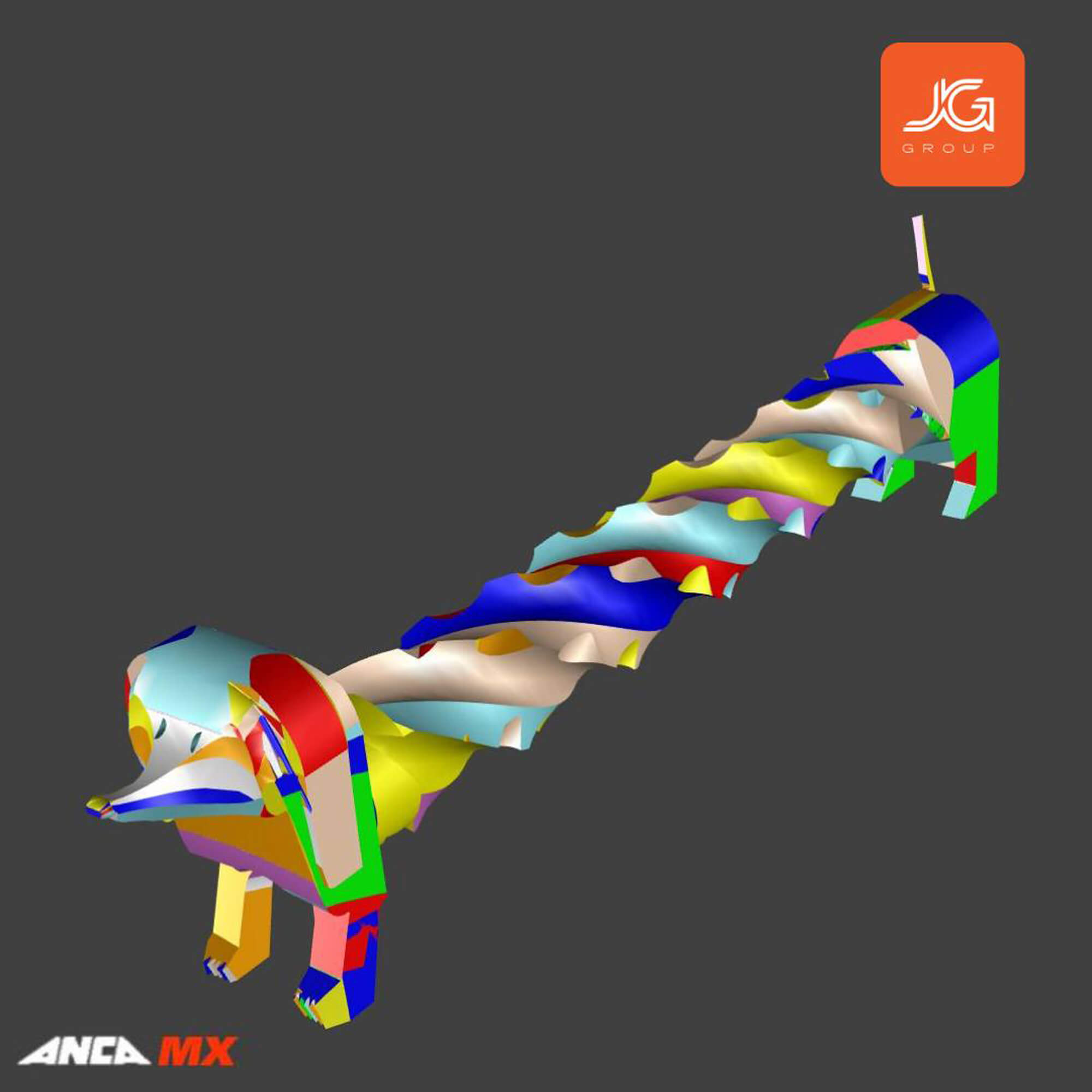

  • JG Group from Poland secured first place in the Virtual Tool Category for the second consecutive year with an impressive simulation of a Dachshund – or more commonly known as the sausage dog, that used 24 profiles just to create the head of its character.

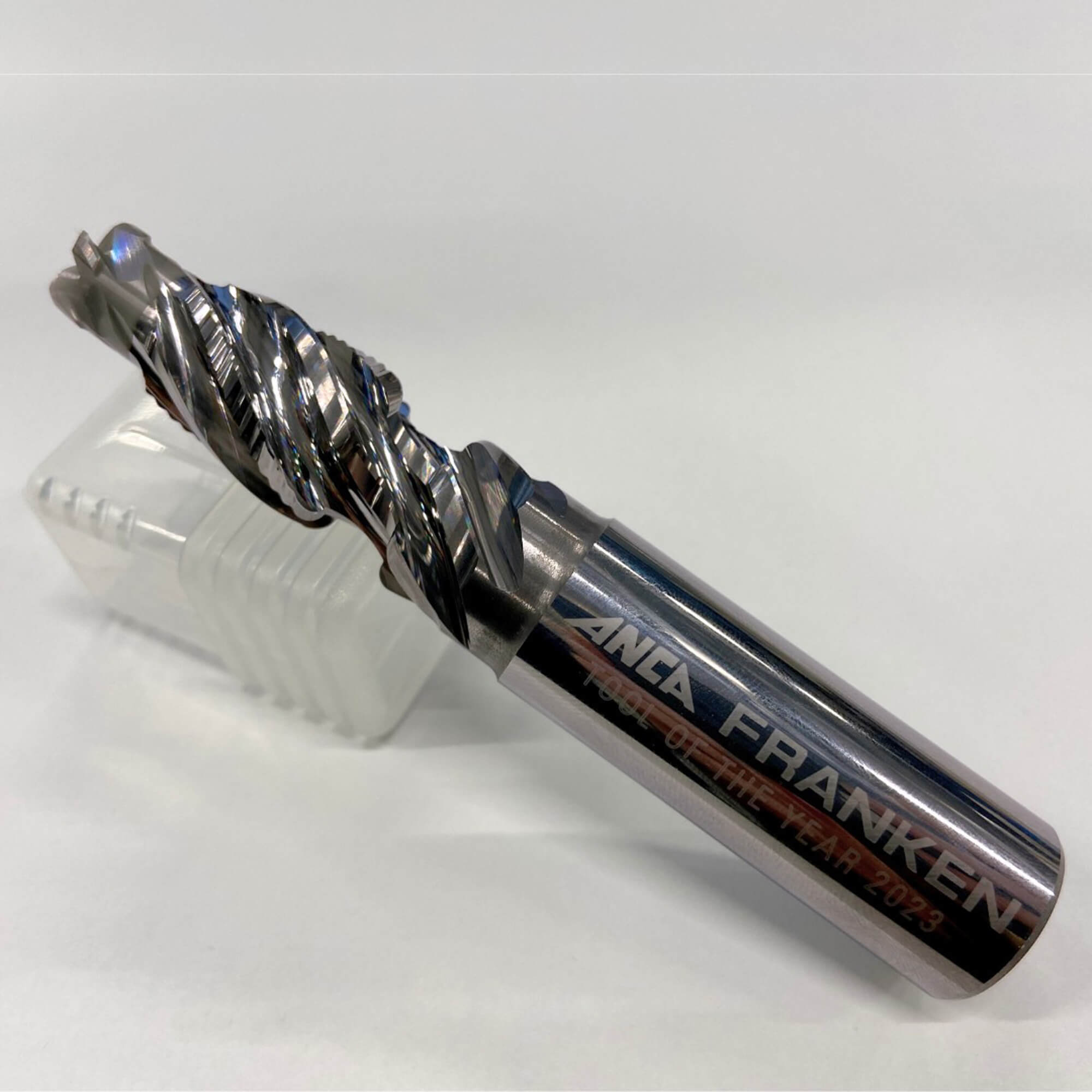

Pat Boland, ANCA Co Founder said: “This year has been marked by exceptional enthusiasm, boasting an impressive array of entries and showing a remarkable complexity in the design of both real and simulated tools. The competition was fierce, but EMUGE-FRANKEN, a globally renowned cutting tool manufacturer hailing from Germany, has truly set itself apart. Their combination of ceramic materials and tungsten carbide posed a significant manufacturing challenge, and effectively extended the performance and lifespan of the cutting tools.”

Diether Ahrens, Head of Business Unit at EMUGE-FRANKEN, commented on their award-winning tool, saying, “ANCA and EMUGE-FRANKEN have a long-standing technology partnership that has enabled us continuously to be innovative. Our team designed and ground an outstanding competition milling cutter based on the new FRANKEN Cera-Cut line. An exclamation mark in function and appearance and thus also a bit of our DNA for innovative special and standard tools for milling.”

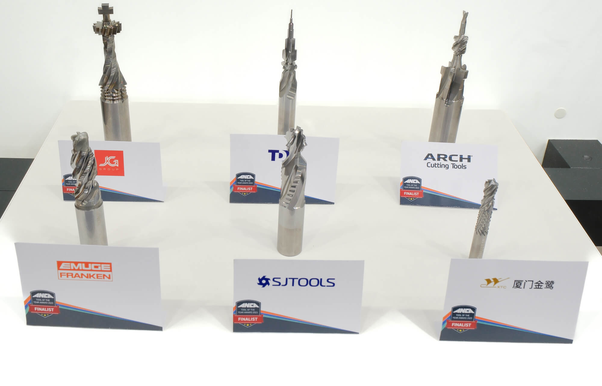

Their winning entry was a complex, multi-functional cutting tool with edges consisting of carbide and ceramic material. Using iGrind to its fullest, this tool makes the most of the profile software’s flexibility, employing layers and segments to assign operations efficiently. Demonstrating exceptional precision in profile measurements and 3D edge radius measurements, the tool closely aligns with its intended specifications and stands out for its accuracy.
Second place: ARCH Cutting Tools
ARCH Cutting Tools continues to create another outstanding multi-functional cutting tool with the required accuracy. Once again, it proves to be a functional tool to replace multiple processes, thanks to its use of profile software, segments, and other iGrind operations during its creation. The cutting edges exhibit consistent 3D edge radius and good levels of profile accuracy.
Third place: TDM Cutting Tools
This tool has been designed to replace multiple processes, and it’s the result of combining profile software, segments, and various iGrind operations. With its profile and edge radius meeting satisfactory standards, it’s worth noting that this is a complex tool overall.

The head of this character was created using 24 different profiles. The process involved the strategic utilization of coolant holes on the initial blank, as well as helix correction, cross-sectional profiling, forming flutes from solid materials, and various profile operations. This is an example of how ANCA’s flexible software can be used – or misused!
