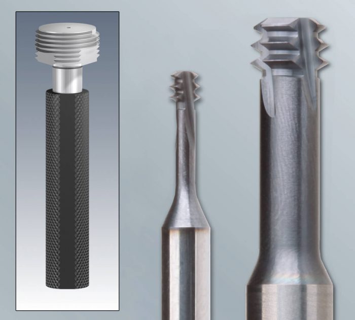

The new ZGF-S-Cut SELF-LOCK Thread Mills with helical flutes, multiple teeth and TIALN-T46 coating produce self-locking threads that are ideal in demanding industry applications such as aerospace where nickel alloys, titanium and stainless steel are the norm. A unique design enables three tooth pitches to simultaneously rough and finish-cut threads, dramatically increasing tool life and reducing cycle times.
Expanded EMUGE SELF-LOCK Line includes EMUGE ZGF-S-Cut Thread Mills (middle and right) and High Ramp Precision Thread Gages (left inset)

The new EMUGE ZGF-S-Cut self-locking thread mills have a left-hand helix flute design with left-hand spindle rotation, which greatly enhances stability and cutting performance. The first of three cutting teeth acts as a rougher, while the second and third teeth finish the full thread profile, providing perfect threads, exceptional cycle time reductions and longer tool life. TIALN-T46 coating resists heat and wear and further extends tool life. “Our ZGF-S-Cut design provides tool life which can exceed 10 times that of conventional thread mills,” said Blandon. The new thread mills are available in 16 sizes from 2-56 up to ½-20″ for UNC or UNF threads, and tools starting at the ¼” size and larger feature axial coolant capability.
New EMUGE High Ramp Precision NO-GO Thread Plug Gages have also been added to the EMUGE SELF-LOCK line. The gages are used to check the lower thread ramp point for possible ramp angle errors and are used along with standard EMUGE SELF-LOCK Thread Plug Gages to verify all thread profile features.
