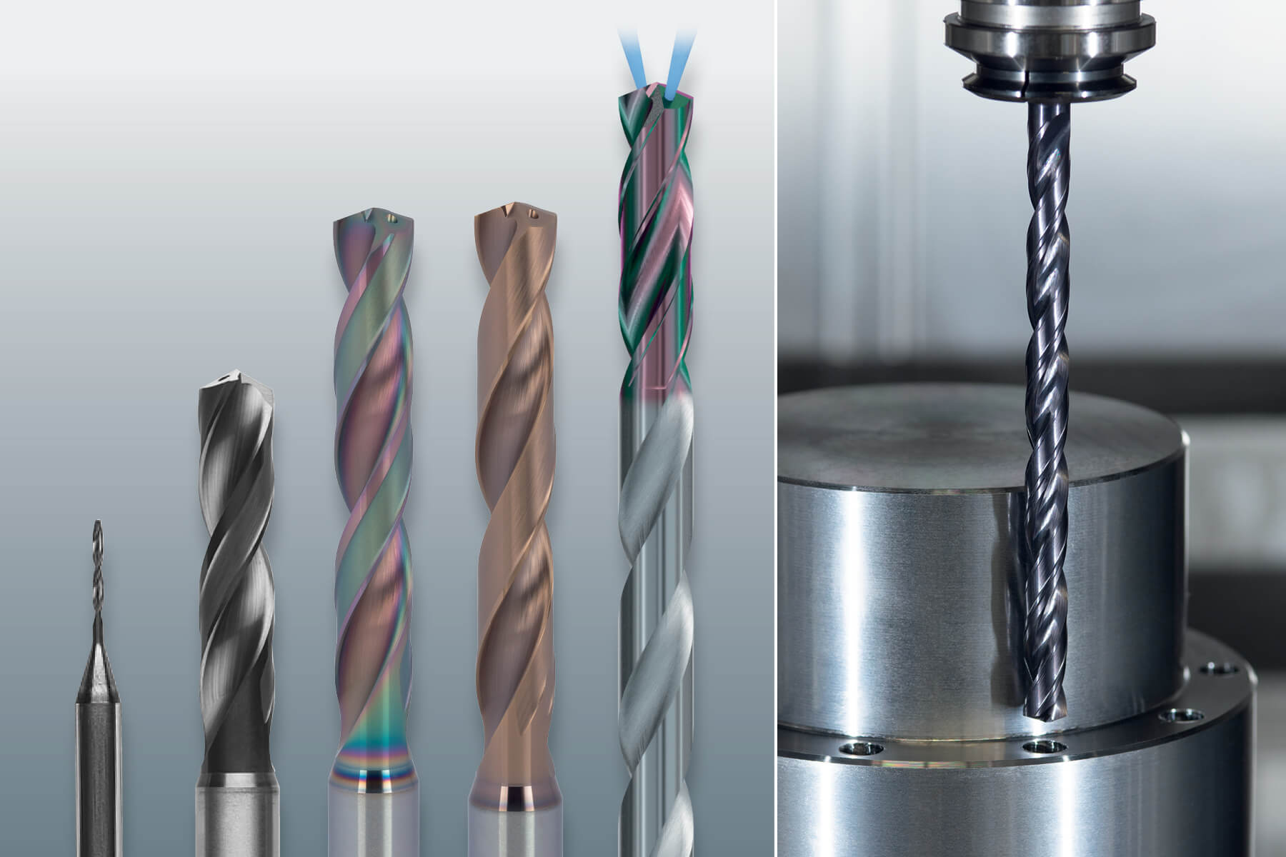

New SteelDrill Line
The new EMUGE SteelDrill line is optimized for steel and cast materials, while also performing efficiently in hard and non-ferrous metals. Key features include a concave primary cutting edge with optimized edge preparation, coolant-through capability, and a double-margin design for excellent stabilization and high-precision hole quality. A proprietary EMUGE coating ensures smooth, high-speed cutting and exceptionally long tool life. This high-performance drill line is available in 3XD, 5XD and 8XD lengths, with diameters from 0.1181″ to 0.7874″ (3.00 to 20.00 mm), totaling 548 SKUs.
New InoxDrill Line
New EMUGE InoxDrill is designed for stainless, aluminum, titanium, and nickel alloys. It features a single-margin design to reduce material adhesion and improve hole guidance, along with a custom EMUGE coating and polishing process. Like the SteelDrill, it includes coolant-through capability and a concave primary cutting edge with optimized edge preparation for superior performance. The InoxDrill line is available in 3XD and 5XD lengths, with diameters from 0.1181″ to 0.7500″ (3.00 mm to 19.05 mm), totaling 372 SKUs.
MultiDRILL Line
In addition to existing 3XD and 5XD lengths, the new EMUGE MultiDRILL line is now available in 8XD lengths in diameters from 0.1181” to 0.6299” (3.00 mm to 16.00 mm), a total of 172 new SKUs. MultiDRILL is the ideal go-to drill for job shops running a many materials—or even in production environments.
The MultiDRILL line also includes new 6XD Micro Drills ranging from 0.0394”. (1 mm) up to 0.1160”. (2.95 mm) in diameter. The new MultiDRILL Micro Drills feature an advanced flute profile designed to enhance chip evacuation of varying materials, and have a radius cutting edge for high shearing action. A specialized point geometry generates short chips and guarantees optimum performance. For heat and wear resistance, MultiDRILL Micro Drills have ALCR-99 coating.
EF 12XD Drills
EMUGE high performance EF-Drills are now available in 12XD lengths in diameters from 0.1181” to 0.5512” (3.00 mm to 14.00 mm), a total of 47 new SKUs. EMUGE EF-Drills are designed for premium performance in demanding applications and materials for deeper hole drilling that require straightness and surface quality beyond a standard high speed steel drill.
