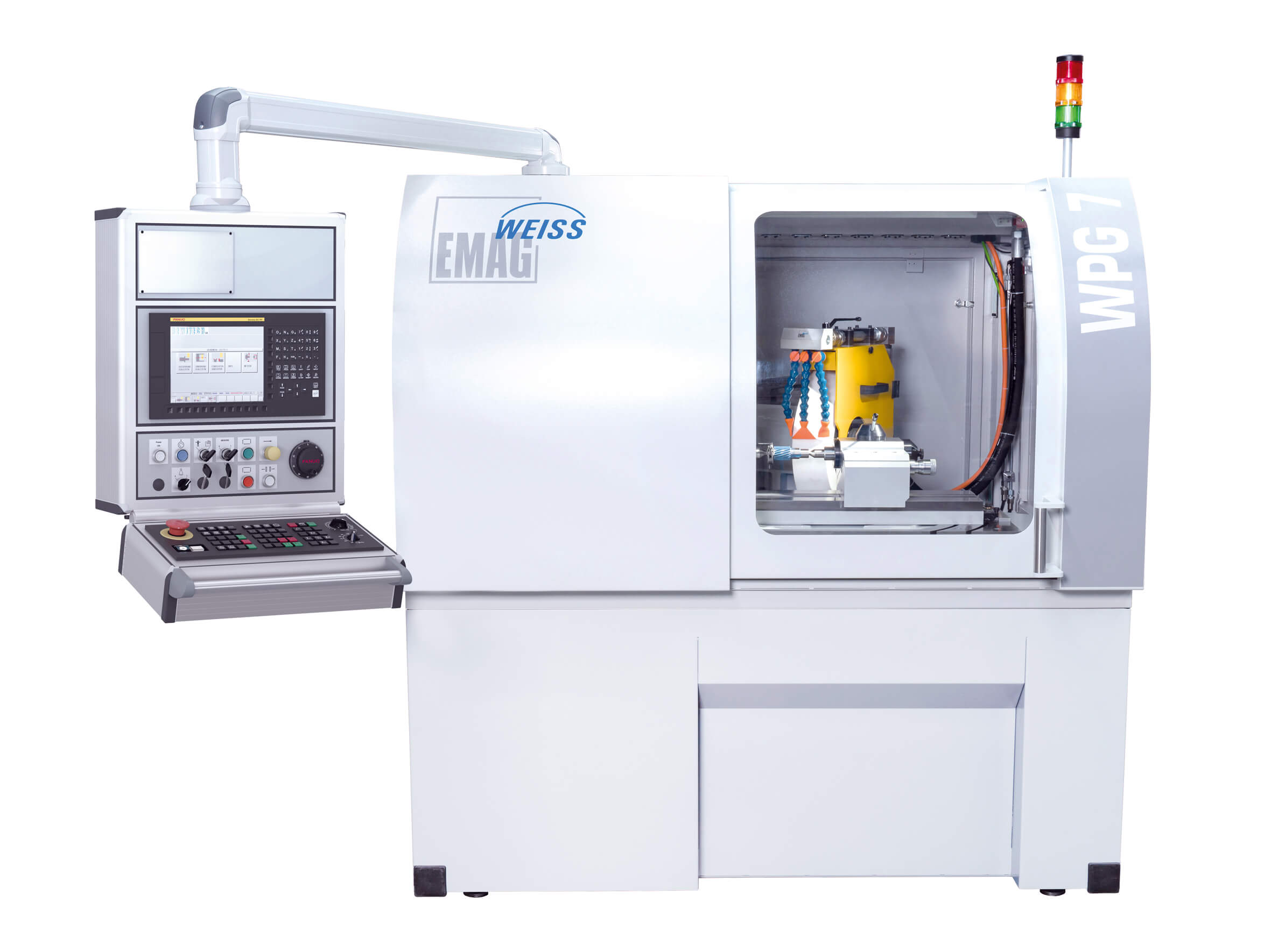

The small “easy to set up machine” has a footprint of just 1.8 x 2.4 m.
If you want to finish small and medium-sized components, you may not need a large grinding machine, is the simple credo of EMAG Weiss with regard to the WPG 7 CNC. The purely external cylindrical grinding machine fits on two Euro pallets and can be easily transported to its location by crane as an easy to set up machine. The grinding process can then be started immediately – without compromising on quality or process reliability, as the WPG 7 CNC has negligible heat build-up thanks to its rigid design. In addition, high-precision in-process measurement with proven Marposs technology, which works independently of the cycle time during the machining process, is available as an option.

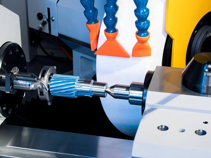

Straight or angled external grinding wheels are used, which have a maximum diameter of 500 millimetres, and can of course also be profiled depending on the task. Conversely, this means that it is not possible to integrate an internal grinding wheel and there is no B-axis for swiveling the headstock. Instead, the rest of the WPG 7 CNC is a state-of-the-art solution including highly dynamic axes, a powerful and controllable grinding wheel drive and a workhead with stationary or live center (MK4/MK5 or W20/W25). The graphical dialog interface of the control panel is also important for the productivity of the solution. It is based on a Fanuc control system and considerably simplifies the input of technology parameters for certain cycles. The basic version of the control already includes all common grinding cycles.

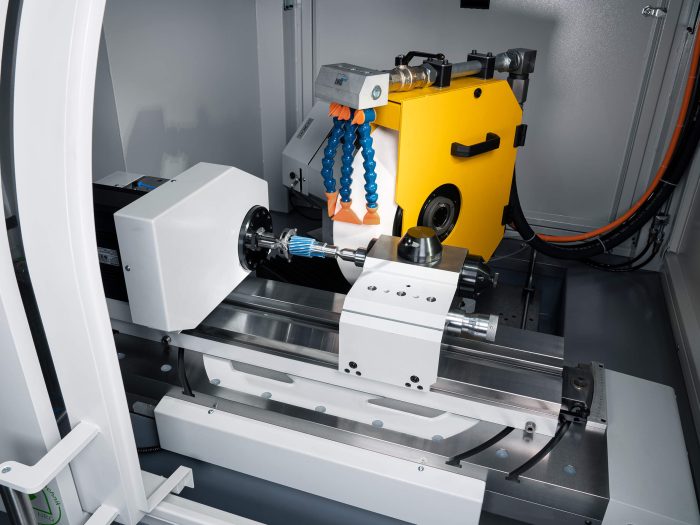

The interior is easily accessible after opening the large front door.
