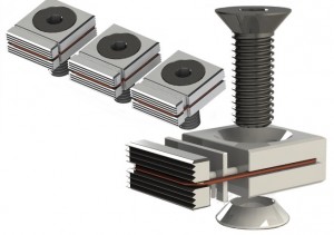

Patented Tiny Vise® edge clamps from Carr Lane Manufacturing offer strong clamping action in a mini size. Ideal for fixturing small parts, the unique clamps grip the side of a workpiece to keep the top clear for machining.
This latest version incorporates a modular jaw design for greater adjustability. The new modular system allows adjusting your workpiece engagement point by adding or removing spacers. This is useful when using the same fixture for machining a family of parts, or when workpiece size can vary somewhat between batches.
Up to three spacers can be inserted to provide adjustment of up to 3/16 of an inch. The modular jaw assembly is held together securely by a tough, durable O-ring, recessed in a protective groove.
Other variations of the Tiny Vise® include a standard version; double edge version, for clamping two workpieces at the same time; a v jaw version for clamping round workpieces; and a double v jaw style.
