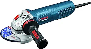

#5 Bosch GWS13-50VSP High-Performance Angle Grinder Variable Speed with Paddle Switch, 5″
A beefy angle grinder that provides a no-lock multi-grip paddle switch for user control and comfort. It is equipped with a two-position vibration control side handle, making it less strenuous to operate.

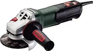

#1 Metabo WP9-115 Quick 8.5 Amp 10,500 rpm Angle Grinder with Non-locking Paddle Switch, 4 1/2“
The most used angle grinder by our followers. Ergonomically designed with integrated non-locking paddle switch for increased safety and more comfort, the fastest wheel change system available, and a tool-free quick-positioning guard that allows for fast change-over from grinding to cutting.
