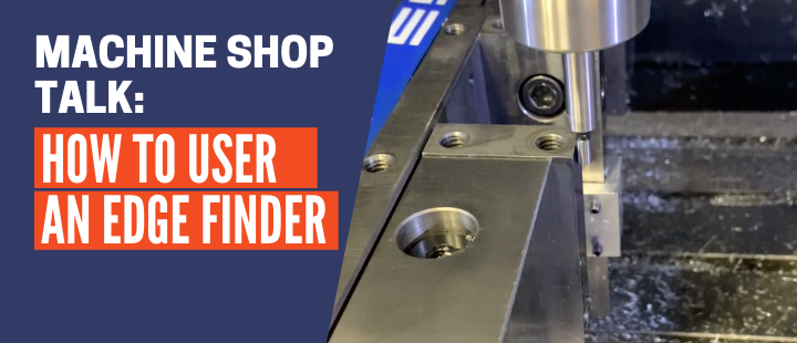

If you use a milling machine to machine parts, then you’re likely to be familiar with edge finders and the way they work.
Edge finders, sometimes also defined as wigglers or wobblers, are simple tools used to locate the edges of a workpiece or the center of a hole. They are also by far the most commonly used device to locate Part Zero.
They are held in a collet, end mill holder or chuck mounted in the spindle of a milling machine or drill press and come in different sizes and shapes, depending upon the inside diameter of the collet used.
There’s a whole choice of edge finders that work and function in different ways. Let’s take a look at them to better understand the advantages and disadvantages and hopefully help you to choose the best one for you:

MECHANICAL EDGE FINDERS
Mechanical edge finders are relatively cheap and work similarly to the wigglers. They have two sections: the body and the orbiting tip. The edge finder has three modes: orbiting, centered and offset. The edge of the part is located at the transition point between centered and offset, as shown in this video.
PROS: Inexpensive and not affected by collet run-out.
CONS: Requires the machinist to understand when the two sections are aligned, which can lead to inaccuracies.

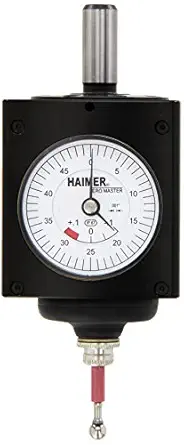

3D SENSORS
3D sensors, sometimes also called 3D tasters, are probably the most practical and easy to use tools to find edges, although they are not cheap. Unlike the other tools listed, they can measure in X, Y, and also Z. The tip of the sensor is connected to a dial gauge. When the dial gauge shows zero, the spindle axis is exactly on the workpiece edge.
Since it’s not uncommon to break the tip, it’s generally recommended to buy one or two extras. You can buy extra tips here.
PROS: Extremely accurate and easy to use
CONS: Expensive

Haimer 3D-Sensor
