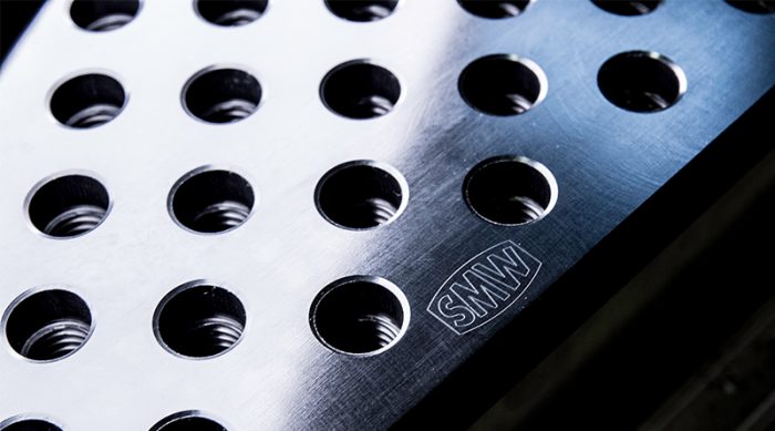

The easier it is to implement good fixturing, the more likely you are to embrace it! One of the best ways to increase the functionality and work area of the machine table is with a fixture or tooling plate.
Check Out the SMW Tool Plate
There are three key benefits to a fixture plate:
1. They can help to quickly and accurately tram in fixtures and vises.
2. They can hold large, complicated, or odd-shaped parts.
3. They protect the cast iron machine table.
