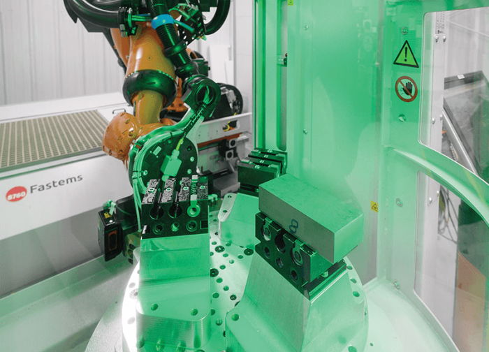

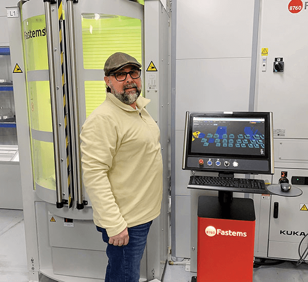

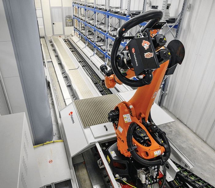

Advanced uses a Fastems ROBO-One Flexible Manufacturing System (FMS). The new system’s largest benefits happen on the front end of the process through the MMS7 controller’s functionalities for scheduling, forecasting, data collection, and document control. (All Images provided by Advanced and Fastems)

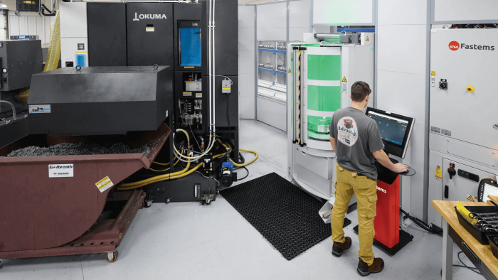

The pride of Advanced’s shop is currently its five-axis machining section, and its beacon is a Fastems flexible manufacturing system (FMS) featuring 36 pallets connected to two Okuma MU 5000s. In that area are also three stand-alone Okuma M460-5AX machines. The entire area is dedicated to five-axis hard metal machining, primarily of aerospace parts. Most days, the section is running aerospace grade titanium such as 6AL4V to create parts such as nacelle and thrust reverser components.

Advanced’s 36-pallet system is connected to two Okuma MU 5000s and run by Fastems ROBO-One Flexible Manufacturing System (FMS).

Advanced had the Fastems RoboFMS ONE (FMS – Flexible Manufacturing System) installed in June 2019. The RoboFMS ONE, which comes with MMS to handle production scheduling and execution, automates the five-axis Okuma machines and has slashed setup time. Shortess said that the RoboFMS ONE and MMS have had “enormous impact on efficiencies such as first-pass yield, spindle utilization and increased capacity, while increasing the company’s reputation for producing quality products and service.”

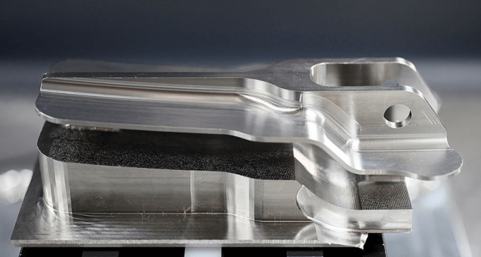

In a shop with many changeovers, the easiest way to save time and money is to reduce setup time. Shortess recalled a complex titanium aerospace hinge assembly part that used to be run on traditional stand-alone machines. This particular part took two hours in setup time alone, even more than the part’s one hour and 40-minute cycle time. “We put it back through new product development with our new system, and our setup time went from that two hours to really nothing—zero—because it is always in the Fastems system,” Shortess said. “We gained that changeover time, and that helps increase spindle utilization.” Advanced is currently running semi lights-out, and complete lights-out manufacturing is the ultimate goal.
Advanced reduced the load-to-load changeover time required to begin machining a titanium aerospace bracket through standardized workholding solutions and immediately saw an increase in spindle utilization after trusting it to Fastems automation.
The new system helps develop processes on the front end before jobs are even started. Advanced uses it to track tool wear and to take advantage of all that can be recorded. “We’re running it in automatic mode, not manual. We’re letting it do what we paid for it to do,” explained Shortess. “We can’t crunch the amount of data that the MMS can crunch. The system looks at tool data, cycle time, everything to predict what it needs. Now we’re talking about stable, predictable processes. If people are not investing in this type of technology in manufacturing, they are just falling further and further behind, in my opinion.”

The bracket took two hours in machine and workholding setup time alone before the FMS was installed at Advanced. Today, that time has been reduced to almost zero.
