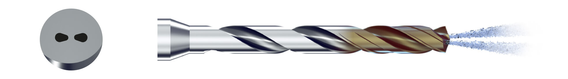

To reduce the heat in the cutting area, the cooling lubricant must reach the machining area directly. The two cooling channels with very large cross-sections carry massive amounts of coolant to the drill tip and guarantee constant cooling including lubrication of the cutting edges. At the same time, the massive coolant jet flushes the chips through the polished flutes and prevents chip jams.
Product overview
The patented special shape of Mikron Tool’s cooling channels enables a 4 times higher volume of coolant to be shot through the tool at the same pressure. This is a further key to success and stands for innovation in the thermal dissipation and chip removal technology.

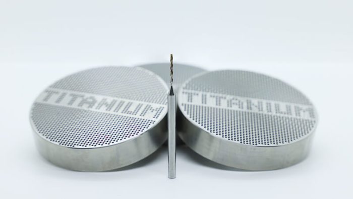

For the cost-effective production of titanium components, tools are required which are specially adapted to the material properties of the various titanium grades.
Titanium material as well as the workpiece are expensive, which is why high process reliability and calculable tool live are so important. If the latter can be improved, so much the better. Mikron Tool’s new high-performance drills for titanium have up to 3 times longer tool life and work with twice the feed than current competitors. Another outstanding aspect: drilling with the ATC-version is completed in one shot, without multiple machining steps.
