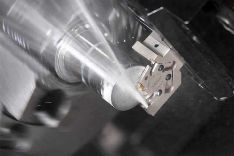

Caron's TMAC MP with adaptive control with image of cnc machining of titanium
Caron Engineering’s TMAC MP is first and foremost a tool monitoring system, with sensors installed on the machine and a separate processor showing spindle and tool data. But combined with a power transducer, TMAC’s strength is in its ability to override the tool’s feed rate and apply adaptive control to optimize cutting, an especially useful feature for hogging difficult-to-machine aerospace alloys. (Images courtesy of Caron Engineering.)
