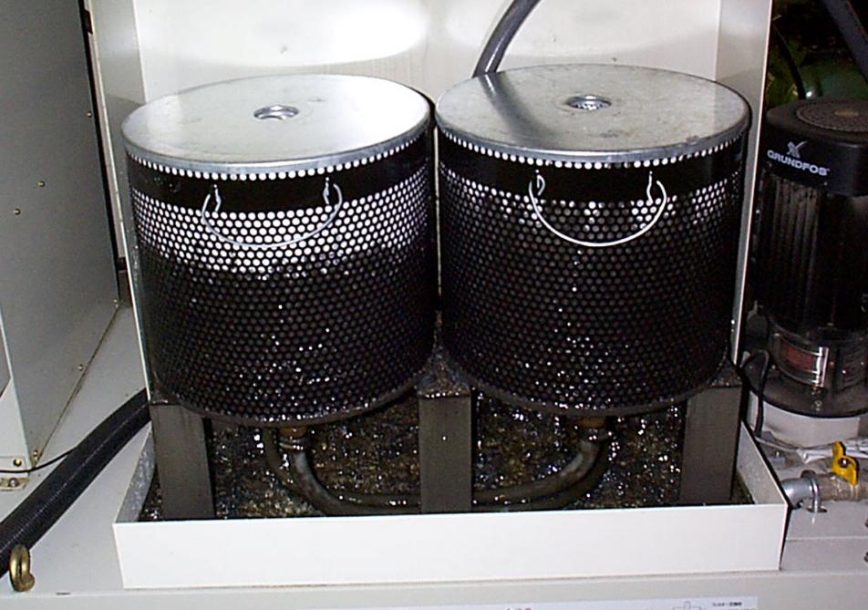

Filters clean the cutting sludge from the DI water for recirculation. They come in many different sizes, shapes and quantities; using the proper size and flow is important for circulation and machining stability. As the load in the filters increases, circulation volume decreases. Life expectancy is controlled by cutting speed, wire size, material type and thickness. They need to be changed in accordance to the filter back pressure reading or volume loss requirements.

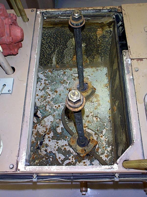

2. Cleanliness
The more often a machine is cleaned, the easier and quicker it is to maintain. Failure to wipe down machine areas regularly will result in build up and will require significant time and energy to restore. Be careful when choosing your cleaners; some acids are very corrosive, which can kill your DI resin. Phosphoric acids are a safe choice, but the area should always be rinsed thoroughly with water after cleaning. Here’s a look at the various machine areas that should be kept clean.
The work table needs to be clean and free of dings or burrs for proper grounding. Plastic grass mats can be placed on the table base to reduce excess spray and collect sludge, if you’re using a non-submerged machine, which will extend filter life. It is important to keep the table tray clear of accumulated sludge, which could cause corrosion and leaks that could rip on the ball screws.

The conductivity sensor is located in the clean tank of the fluid system. It measures the current carrying levels of the water in between the two probes. If dirty, the sensor reads lower than the water’s actual level. Exact levels of water conductivity must be maintained for accurate cutting. If levels are too high, it will cause extreme rust, oxidation and cobalt erosion. A conductivity sensor requires about 10 minutes to clean and should be done every 300 hours.

A filter pump’s intake screen can be very problematic. It can get plugged with paper towels, shop rags or large flakes of dry sludge. Screen blockage will affect circulation and machine performance. This should be checked by hand regularly or on a weekly basis.

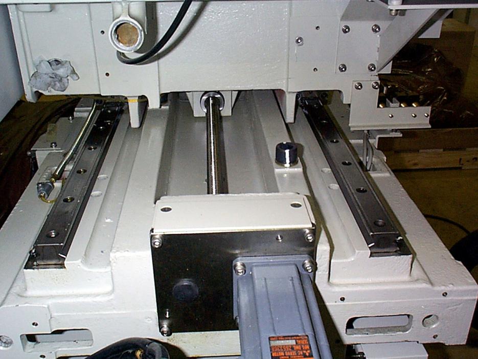

4. Lubrication
Machine lubrication is important to overall performance. All machines run on ways and move with ball screws. Check with OEM specifications for the recommended lubrication schedule. Positioning accuracy depends on the smooth operation of these items. Wire cut surface finish can be affected by bad ways and screws. Always visually check for the proper lubrication of these surfaces. Some machines use grease, some use way oil and others use a combination of the two.
Some machines require the UV-axis be greased by hand. The small ball screws and ways are just too difficult to cover with an automatic system. Some machines offer either automatic or hand pump way oiler systems. It’s important to check which items (ways and ball screws) these systems cover. Don’t assume they cover everything. Visually inspect that each lubrication point is receiving its fair share. A plugged line can cost major repairs and downtime.
