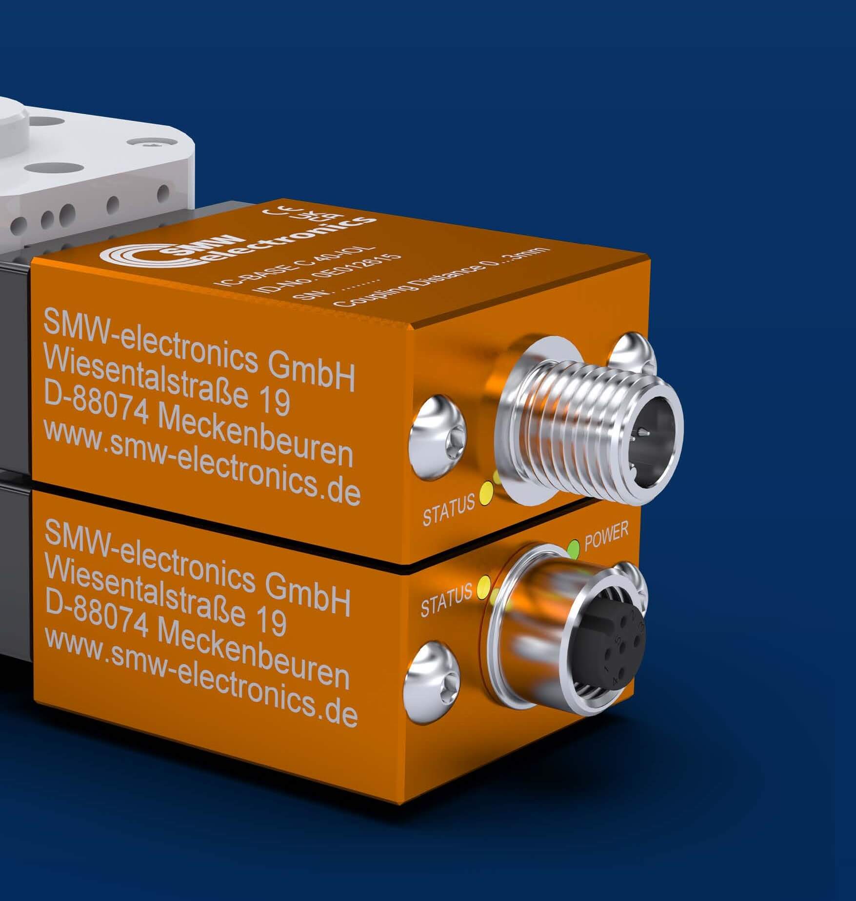

C40 Inductive Coupler Features Inductive Signal Transmission
The C40 Inductive Coupling System, designed for contact-free transmission of power and data between moving/rotating and stationary components, providing an alternative to standard mechanical pin , eliminating wear and maintenance concerns. This innovative solution provides seamless and efficient operations for robotic tools and pallet changers.
Ideal for EOAT application requirements, C40 features standard mounting plates for various market available Tool-Changer systems. Key features include contact-free transmission of energy and signals, energy transmission of 15W (24V), signal transmission via IO-Link or 6xPNP, 2xAnalog 0-10Va cubical coupling system measuring 40x45x22 mm, and a transmission distance ranging from 0 to 3 mm.
The elimination of contact-based, wear-prone pin connections minimizes downtime and wear costs, ensuring maximum efficiency and productivity.
