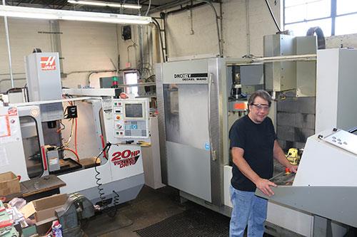

Yet as productive as the lathe is, even more production happens in its immediate vicinity. Ergoseal’s new way of thinking about production emphasizes cells, Tom Hilaris says. Walking time can be reduced even further by anticipating where a part is likely to go next and bringing that subsequent operation close to the machine tool. Parts produced at the ST-20 lathe go into a press-fit assembly operation, so the work cell around this lathe now includes all of the resources the operator needs to perform this assembly while the machine is cutting parts.
A cell has also been built around the shop’s latest CNC machine, a smaller Haas ST-10 lathe. This machine produces “cups,” components common throughout the company’s seal assemblies. All cup parts are roughly similar, but this machine produces a range of sizes and varieties for a range of customers’ seals.
For any cup part, two machining operations are needed. The part’s inner region is turned to allow lugs to be welded inside. After this welding, the part returns to the lathe so the burn marks can be turned from the OD. Because of this series of steps, work-in-process inventory also used to be common for this part, until the company installed the spot welder in a cell with this lathe. Now, the operator can move the part from machining to welding to machining without walking at all. This truism about manufacturing is so simple and powerful that it is almost profound: Just the positioning of your equipment can determine how much work your shop is able to do.
Together, the two newest machines in the shop, the Haas lathes, are now productive enough within their respective cells that they account for the lion’s share of the shop’s machining output. Other, older machines in the shop are still valuable and still deliver significant production, but the pressure on these machines to deliver all of the company’s part-making capacity has been relieved.
As a result, the value of these machines has changed. The way the company looks at them has changed. While the new lathes are more purely production resources, these older machines can increasingly serve the company in its efforts to build up the business. These older machines perhaps can’t keep up with the production processes that Ergoseal is developing in other corners of the shop, but increasingly they now can be available to run the prototyping jobs that will lead to further growth.

The lion’s share of the shop’s machining is now done on the …ngly available to develop more business through prototyping.
The lion’s share of the shop’s machining is now done on the shop’s newest machines. That leaves older machines increasingly available to develop more business through prototyping.
