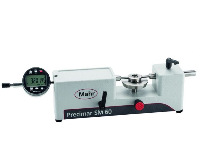

High resolution digital indicators may provide the performance needed in place of a bench amplifier.

One of the strong points that bench amplifiers had over the digital indicators was accuracy and resolution. Getting to submicron measurements has always required a full-feature bench amplifier. But again, technology is giving this capability to digital indicators. There are now high-resolution digital indicators with submicron resolution and performance, providing ranges that can outperform a bench amplifier.
