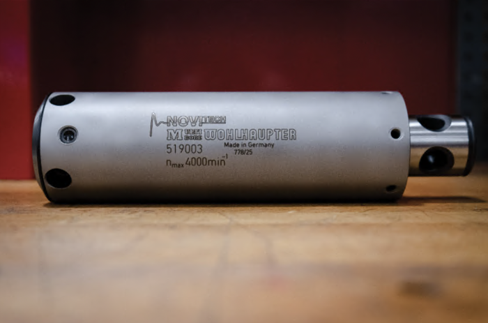

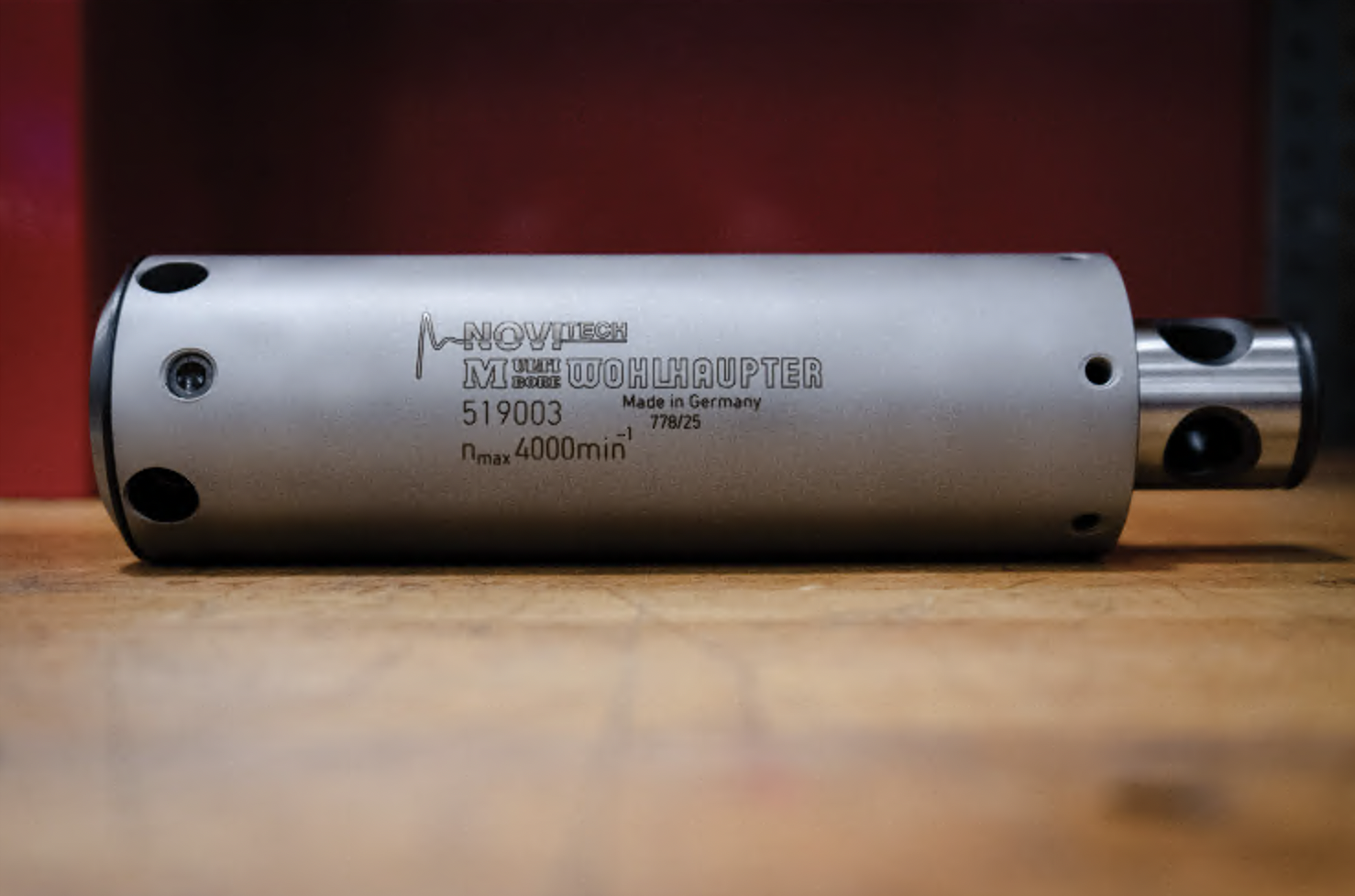

Another important tip is to keep the tool as short as possible to reduce deflection, which can cause poor finish. Length-to-diameter ratio is extremely important to boring tools. Ideally, the length-to-diameter ratio for non-dampened boring systems is 5xD or less while heavy metal, carbide and vibration dampening technologies can allow boring of up to 10xD. Natalie Wise, product manager of Allied Machine’s boring product lines, shared that “Our NOVITECH modules utilize viscoelastic fluid to minimize vibration allowing bore depths up to 10xD. Not only does this vibration damping technology improve the life of your boring tools, it also extends the life of the spindle while producing an outstanding surface quality.” With modular boring systems, it is important to consider the components selected for a job and then attempt to remove any unnecessary length. Because when it comes to boring tool solutions, the shorter and more robust, the better.

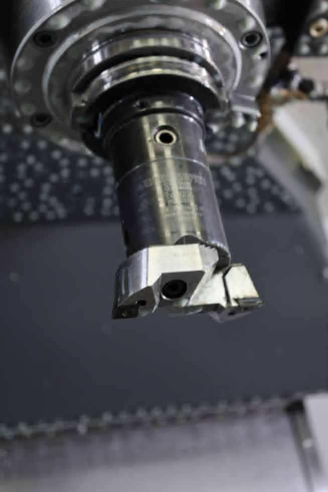

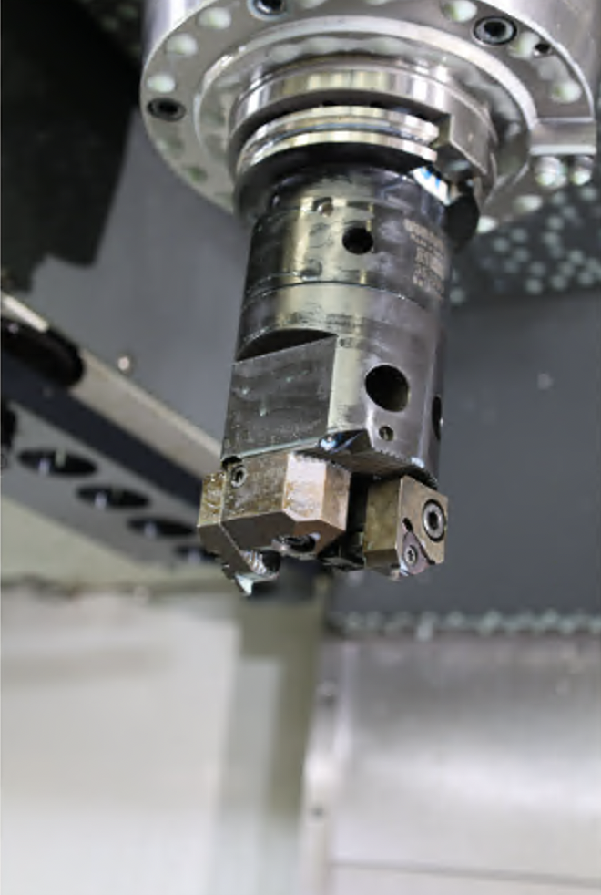

Custom boring tools are another option to be considered when selecting tooling. From reducing cycle time and improving a component’s quality to providing cost savings by combining multiple bores into one operation, special boring tools provide a variety of benefits. At the same time, while many boring applications can run off-the-shelf tooling, there are always unique applications that require special solutions. Complex hole profiles and machine tool magazine limitations demand one tool with multiple diameters and steps. Another example would be the development of line boring tools, which were created due to the inherent limitations of boring tools when it comes to length and the need to achieve concentricity between separate holes as well as the roundness and diameter tolerances of each. Ultimately, custom boring tools provide many benefits but are often developed based on the particular needs of an application.

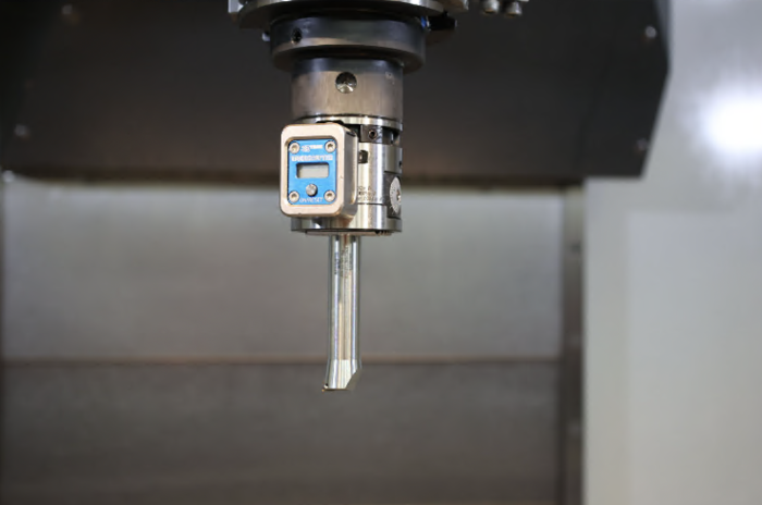

  • Integrated digital tools – Some digital boring heads have coolant pressure limitations. Exceeding those limitations can result in damage to the internal components of the boring head. Many shops run 1000 psi pumps, which unfortunately can cause seals to fail. Particularly in finish boring, this coolant pressure is not necessary. The chips are often so small that it is overkill for chip evacuation, so if the chip control is proper, 300 psi is very acceptable.
