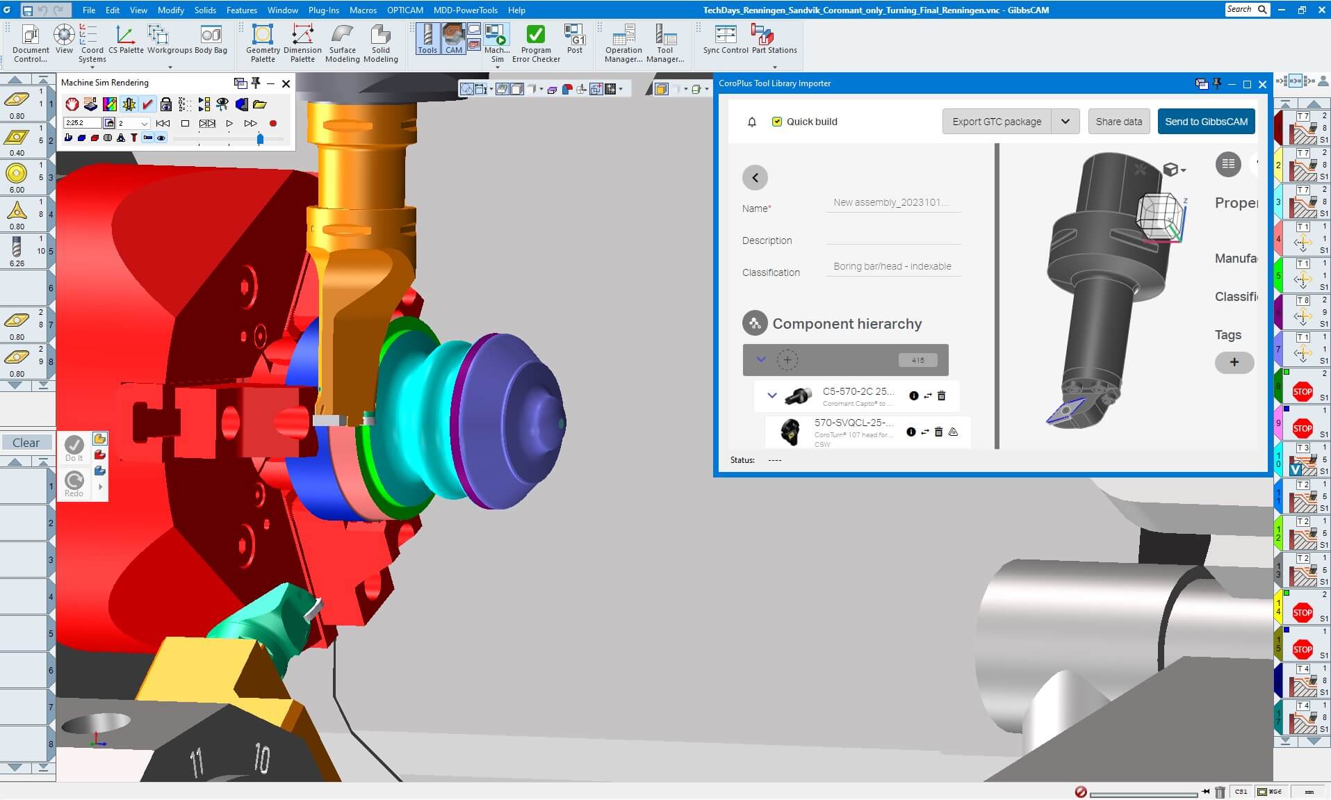

GibbsCAM 2024 features a number of significant enhancements to core strengths while bringing a stronger emphasis on digital connectivity. Version 2024 unlocks the power of Sandvik Coromant through a direct integration with the CoroPlus® Tool Library, providing access to the right cutting tool for your specific operation and offering instant cutting data recommendations. It provides up-to-date cutting tool data, 3D models of cutting tools and holders, and essential information to make informed decisions for optimized manufacturing processes. All data is verified and adheres to the ISO 13399 international standard for cutting tool data representation and exchange. The cloud-based nature of the tool library means that users of GibbsCAM 2024 can access data from anywhere with an internet connection, making it invaluable for organizations implementing company standards, or users who work remotely or across multiple locations.
The integration of the CoroPlus® Tool Library allows users to define tool assemblies and relevant cutting conditions and import the data directly into GibbsCAM.

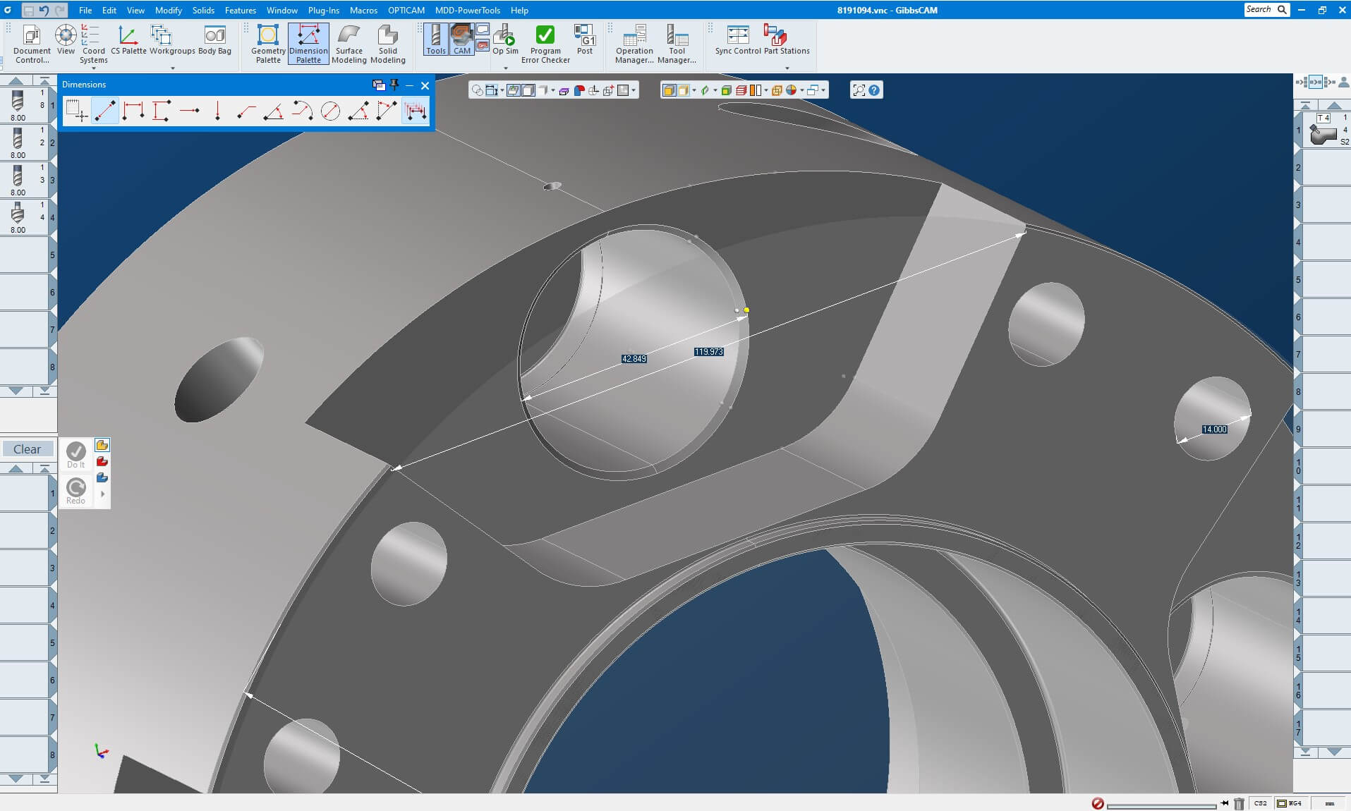

Users can interrogate virtual points for dimensioning part geometry.

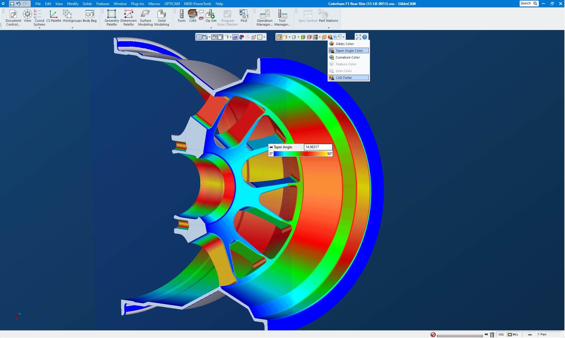

Working with CAD data is easier. Users can interrogate virtual points for dimensioning part geometry such as edge mid points, end points, intersection, circle centre, and circle quadrants directly from the 3D model. A newly introduced visualization tool can map the curvature and the relevant taper/draft angle directly onto the 3D model. This is particularly useful tool for analyzing the minimum tooling diameter required to cut a part since it negates the need to pull extra reference geometry.
A new visualization tool now maps the curvature and the relevant taper/draft angle directly onto the 3D model

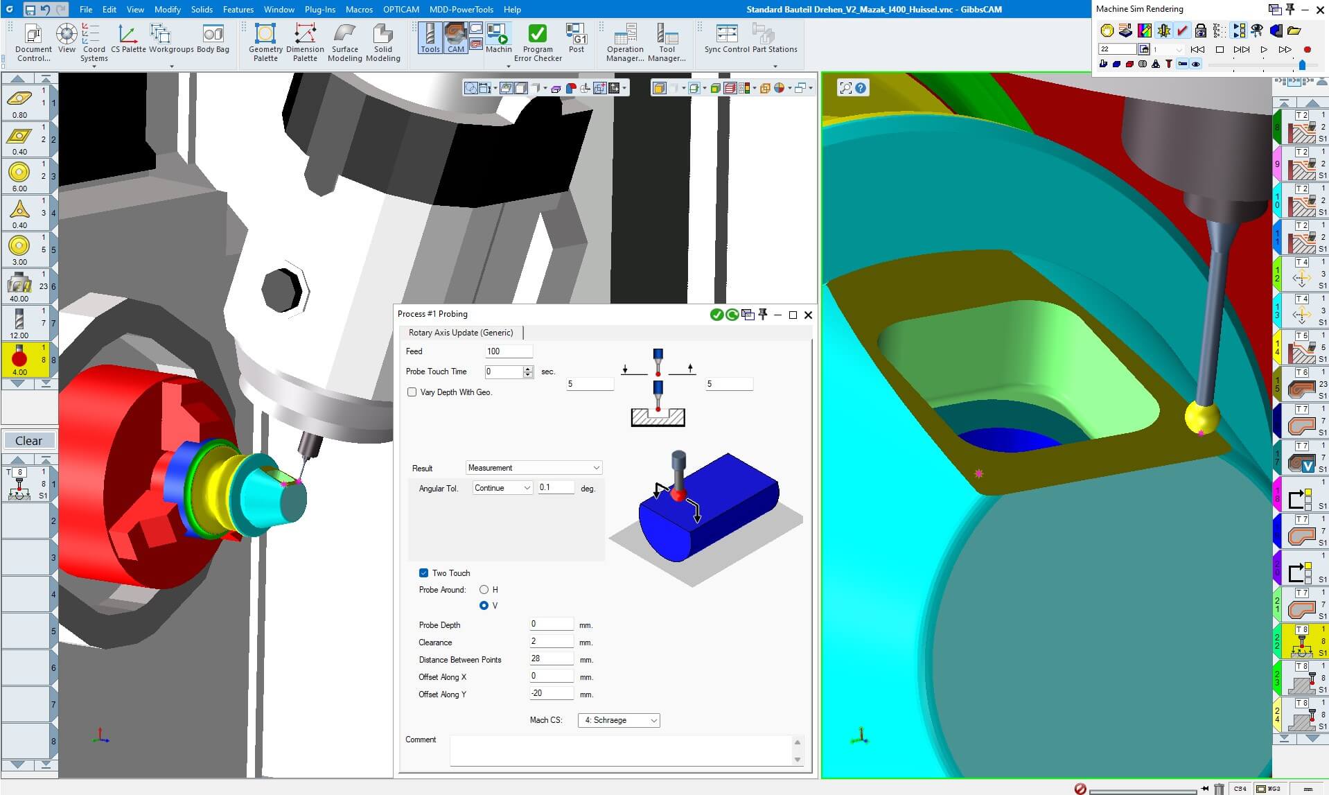

Alongside many other enhancements, generic probing now supports rotary part alignment and positioning. Selecting only the rotary axis, clearance, and shifting parameters will drive the system to probe the surface and calculate the part rotation alignment.
Generic probing now supports rotary part alignment and positioning.

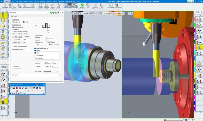

A new mill cutoff process for mill-turn machines and bar-fed mills now supports perpendicular cutting with an end mill, or parallel cutting with a side mill or slitting saw.

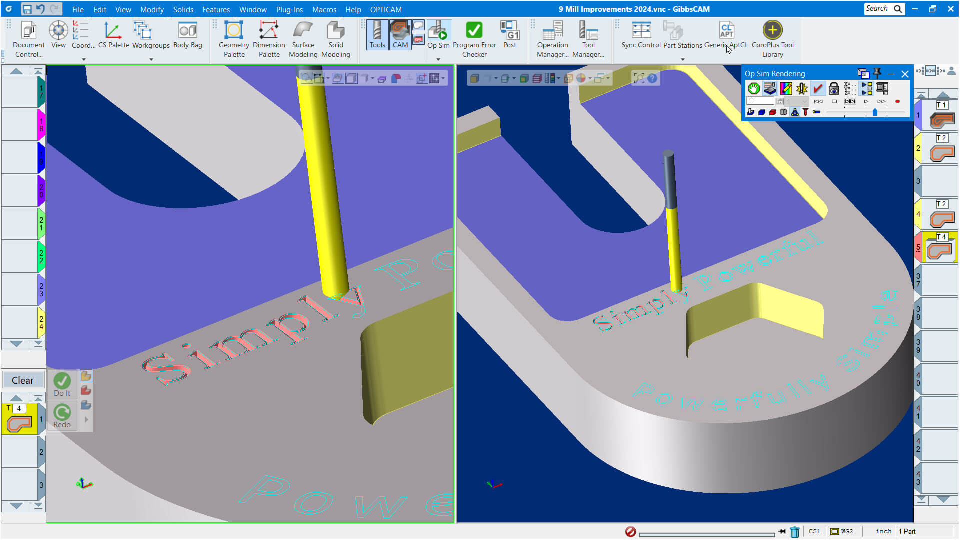

Also new to GibbsCAM 2024,  variable-depth engraving greatly improves the use of complex fonts with tapered tooling and corner ramping. In addition, selectable alignment options are added to control the starting position of operations using a rotary axis. Users can override the default singularity rules, which is useful for keeping the toolpath within machine limits (frequently Y-axis) or machining on the opposite side of a mill/turn part.
Fig3: Variable-depth engraving is greatly improved when using complex fonts with tapered tooling and corner ramping.

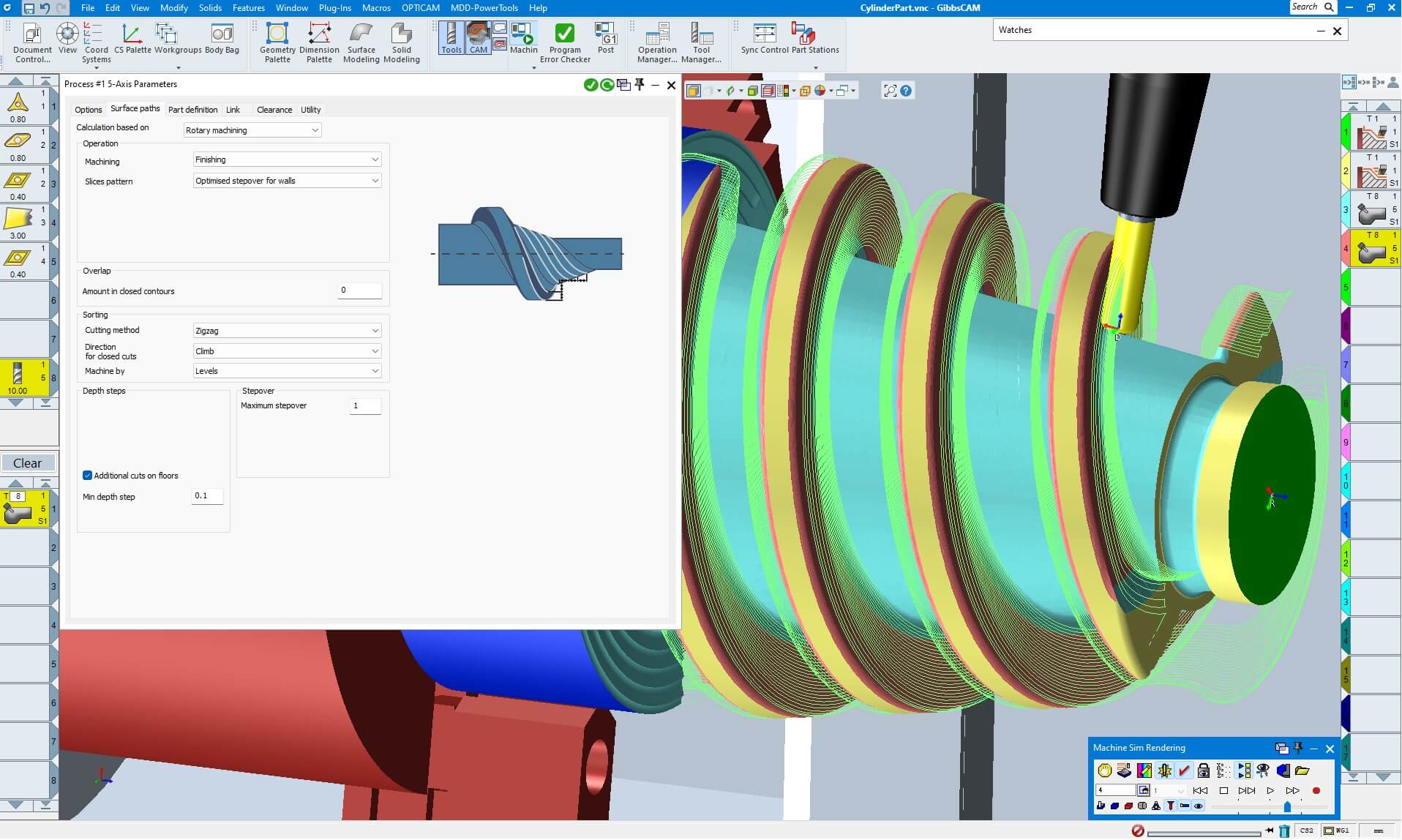

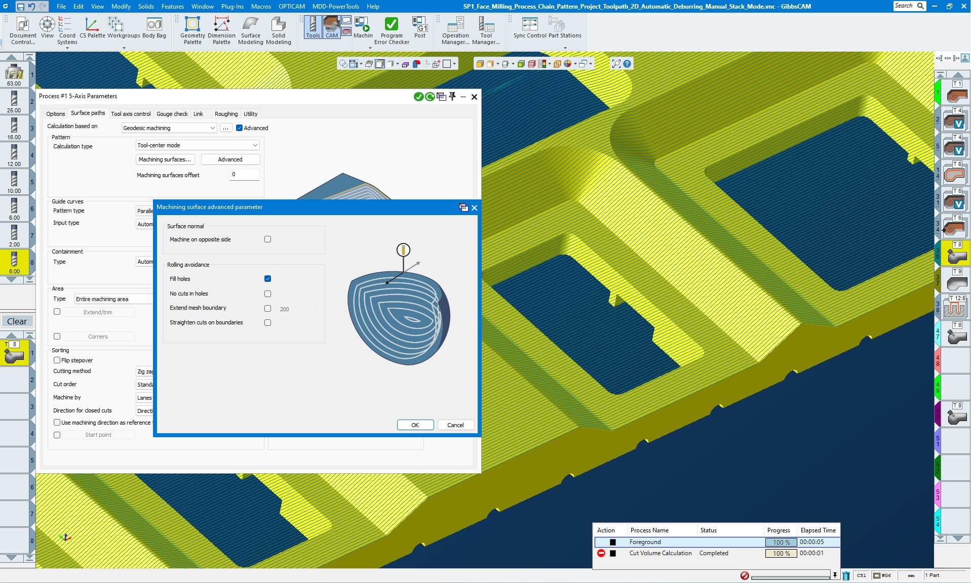

New 5-axis features include an optimized stepover feature for finishing walls and cylindrical or conical floors that creates a better, more consistent surface finish. New geodesic operations perform straight cuts on end boundaries and improve hole filling to prevent the tool dropping down into open cavities. Other improvements include user-defined tool orientation on lead in and lead out movements, and linked entry feed distance. Multi-axis machining enhancements include better management of 3D containments, improved point distribution, ramp offset for the first pass on roughing cycles, user defined start points for finishing, and tool tilting during helix entries.
Optimized 5-axis stepover for finishing walls and cylindrical or conical floors that creates a better, more consistent surface finish.

Improved hole filling for geodesic operations to prevent the tool dropping down into open cavities.
