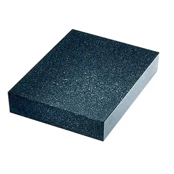

Surface plates are, quite literally, a machining fundament. They are exactly what they sound like: flat, solid plates (typically square or rectangular) that are used as the main reference point in precision inspection. The selection of your surface plate should be thought out since it will become an integral, structural element of the machine in which it’s mounted. Let’s look at a few key characteristics of surface plates along with some model recommendations.
Material
Surface plates come in a wide variety of materials, such as granite, cast iron, steel and glass. Most machinists prefer to use granite because of its inherent properties. Granite’s hardness, low thermal expansion, and no rust/corrosion quality make it the least likely to warp. There are two types of granite, pink and black, but there are fundamental differences between the two beyond just their color grade. Black granite is most commonly used and is best for applications that have significant load bearing requirements. Pink granite is not as strong as black granite but is incredibly resistant to wear. If your application requires frequent movement across the surface, pink granite your best bet. Keep in mind that the thicker the pink granite surface plate is, the heavier of loads it can bear.
Applications
Surface plates are usually associated with coordinate measuring machines (CMMs), precision optical assembly, or high precision industrial machines.
Surface plates are great for marking out, or transferring a design or pattern to a work-piece. Additionally, they are great for baseline work-piece measurements in machining and gage work.
Accuracy and calibration
The accuracy of a surface plate boils down to its flatness. Due to high frequency use, warping, chipping, and wear cause unevenness in areas of the surface plate. Even swarf causes damage to the plate, which is one of the many reasons why removing debris is imperative. A localized area of wear is common, due to the constant use of a particular tool, like a height gage, in the same spot.
Calibration and reworking of the surface place is normal and will happen regularly. However, before diving into calibrating your surface plate, you have to determine if it’s out of tolerance.

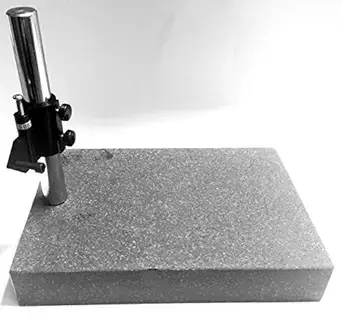

HHIP Granite Check with Fine Adjust
HHIP 4401-0019 Granite Check with Fine Adjust, 12″ x 8″ x 2″
Order now
This surface plate by HHIP is ideal for levelling small plane beds, has a fine adjustment attached and achieves 0.00005″ granite flatness.

    You skipped right over gray granite. Also, there is really no such thing as “Black” granite. Black surface plates are made from Gabbro, Which is stringer than granite, which is why they are usually thinner than their gray or pink counter parts.
