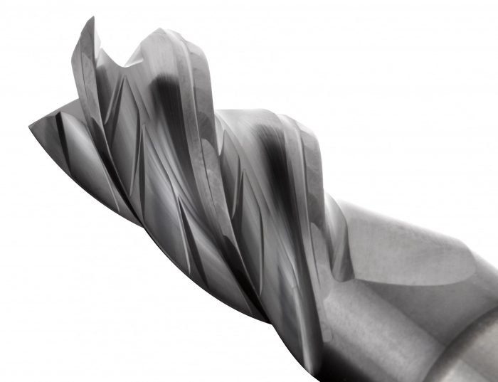

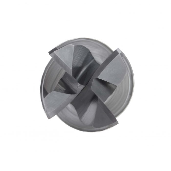

Much of the machining magic happens right here, with the innovative twisted end face of HARVI I TE. Increasing corner stability, enabling soft cutting action even at highest ramping angles.

Innovative chip gashes within the flutes reduce cutting forces and support efficient chip evacuation.
Consider chip evacuation. The HARVI I TE has an innovative flute design that helps curl and break chips into manageable pieces, while a series of chip gashes within the flute lift those chips up and away from the workpiece. Both serve to promote coolant flow, eliminate chip re-cutting, and improve tool life. A twisted end face and unique gashing further promote chip evacuation but are also responsible for the HARVI I TE´s awesome ramping and plunging capabilities.

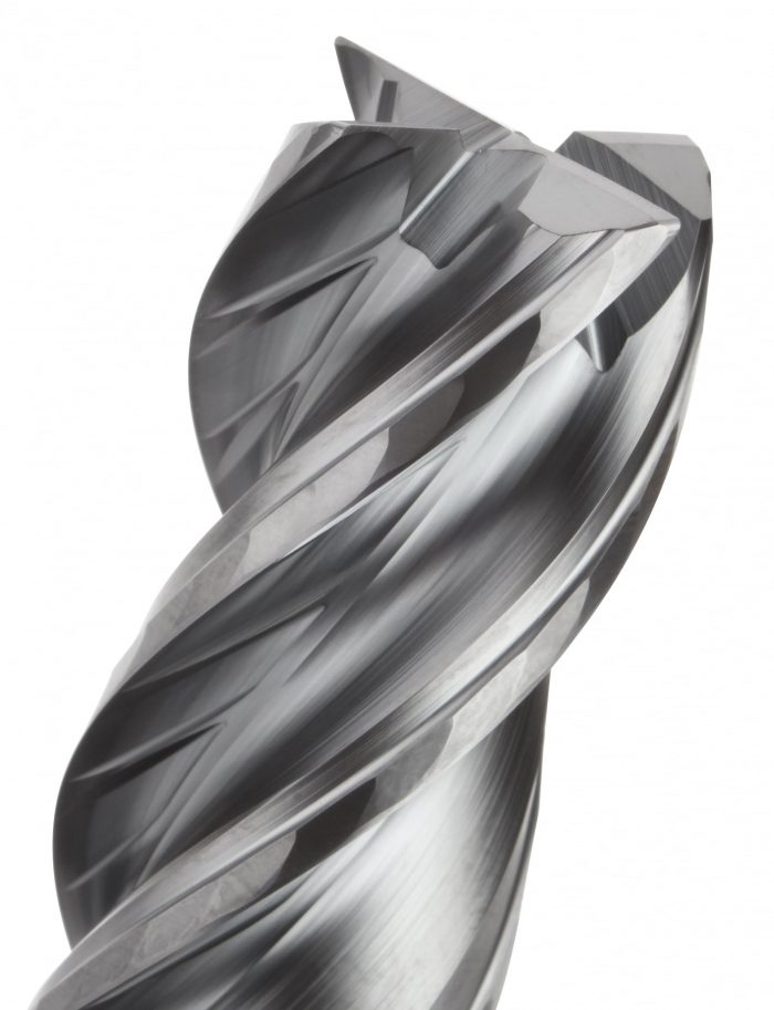

Tool deflection is reduced thanks to the tool´s parabolic core, as well as an eccentric, faceted relief along the entire flute length that significantly lowers cutting friction. This relief also increases edge strength, making the tool a versatile solution.
Anti-Vibration-Anti-Friction Technology- AVF. A Precision faceted eccentric relief for excellent cutting conditions in multiple materials.
Together with a variable helix angle and asymmetric flutes it dampens vibration before it can negatively affect machining operations.
