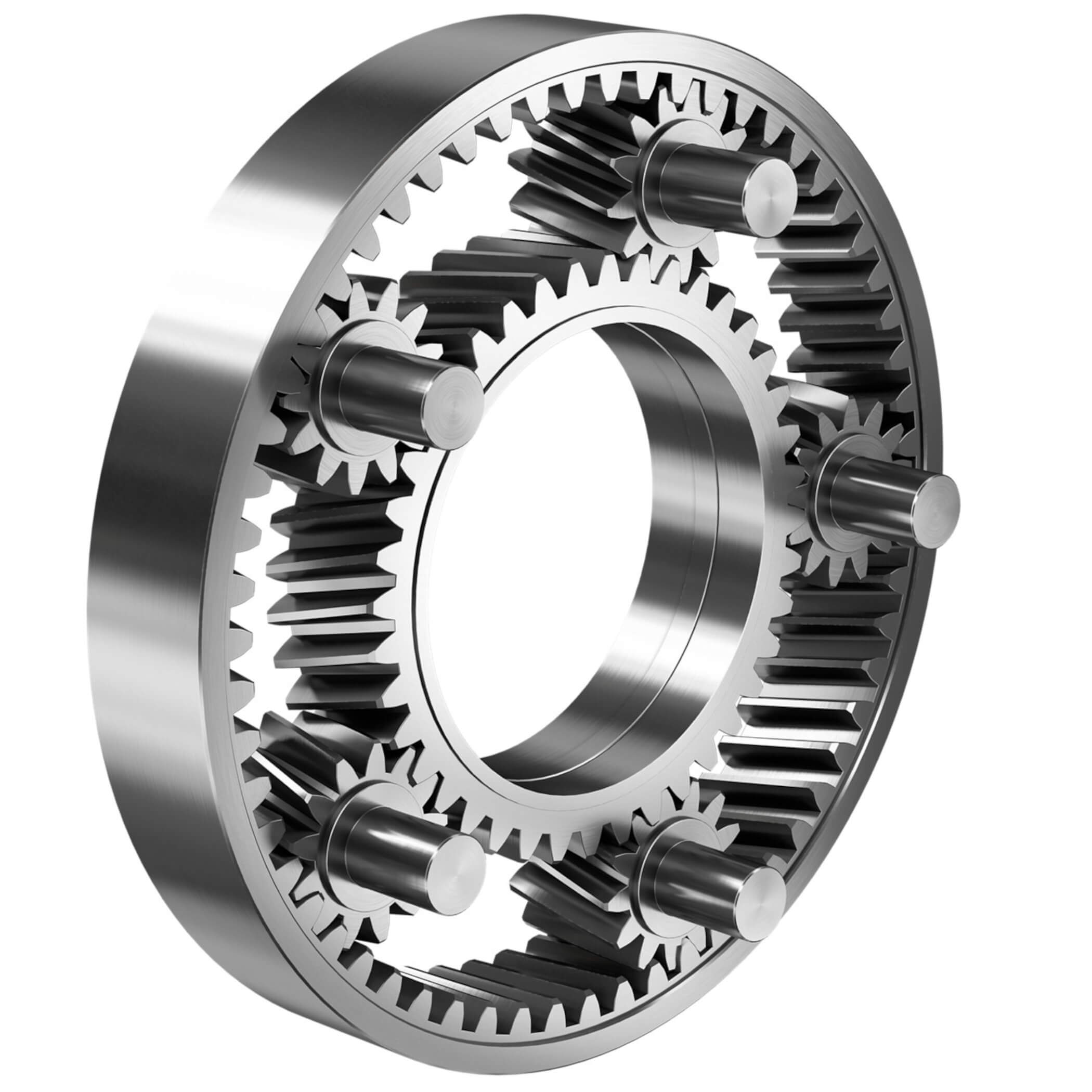

EV transmissions usually have a planetary design, with the planetary gears and the sun gear assembled inside the peripheral ring gear for a compact, lightweight assembly. The ring gear is the most difficult component to produce due to its thin walls and strict roundness tolerances. Unfortunately, traditional manufacturing processes can compound these issues with negative impacts on both time and cost.

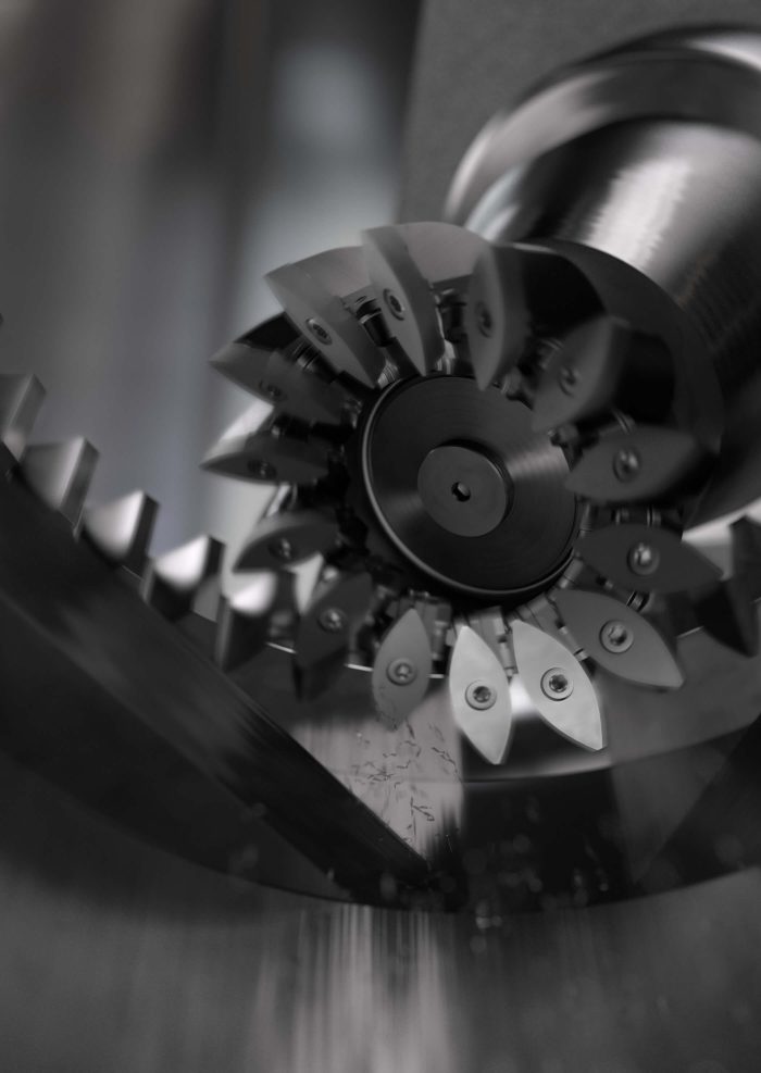

As mentioned, the ring gear is the most difficult component to produce in a planetary gear, but the concept of power skiving — which has actually been around for over a century — is emerging as the most efficient way to achieve this. Power skiving is a process that combines shaping and hobbing (a machining process for gear cutting) into a single, continuous cutting process.
This has several significant advantages over traditional machining methods. Instead of relying on a single-purpose machine, with power skiving a complete component can be machined in one multi-task machine for higher productivity and flexibility. There is no need for specialized machines, and quality restrictions due to machine changes can be eliminated entirely. This significantly reduces the total production time compared to processes with broaching, shaping and hobbing, for more manageable and predictable component machining.
Power skiving is becoming more popular, with over 700 power skiving machine tools delivered since 2014. The majority of these ― over 60 percent ― are multi-task machines. That means the main machining processes happen within the same, single setup. This improves the quality of the component and enables more efficient machining.

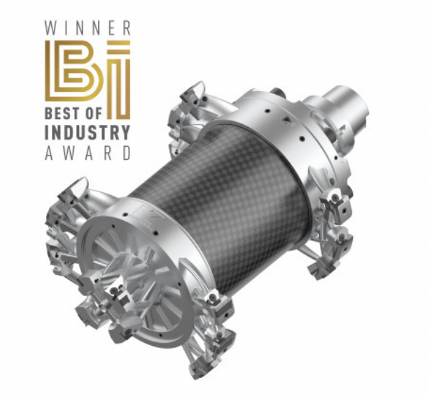

Sandvik Coromant has developed its own high-quality tools for power skiving that are optimized to support its customers for accurate machining of EV transmissions, such as the CoroMill® 178, a solid power skiving cutter that can be ordered as powder metallurgical high-speed steel (PM-HSS) or solid carbide. In addition, the CoroMill® 180 is an indexable insert cutter with railed insert seats designed for excellent and repeatable accuracy. The tools can be optimized in terms of stiffness and overhang, coolant supply and maximum tool life. These combined factors offer reliable, round-the-clock production.

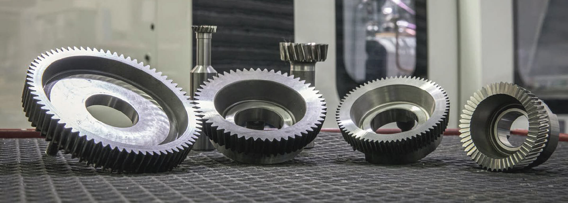

In one example, when a manufacturer of main gears in low-alloy steel wanted to replace their time-consuming shaping process, they turned to Sandvik Coromant. The customer replaced their existing processes with power skiving and was also able to replace the four dedicated machines they used previously with just two multi-task machines.
In the end, the customer’s machining time was reduced by 90 percent, with considerably increased tool life. In other instances, power skiving was shown to be two to three times faster than traditional processes.
