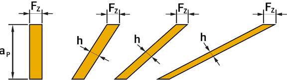

High feed mills take advantage of and exploit a concept known as axial chip thinning.  This is a geometrical anomaly that occurs because of the milling cutter having a lead angle less than 90 deg.  Axial chip thinning shows us that while the lead angle of the milling tool becomes lower, the actual chip thickness is less than the advance per tooth.  And, the lower the lead angle, the lower the actual chip thickness, or the greater effect from axial chip thinning occurs.  For example, if we feed a milling tool at .006” advance per tooth with a 90 deg shoulder mill, we would expect the chip thickness to be equal to .006”.  However, if the milling tool has a lead angle, we would expect the chip to be less than the .006” by a factor equal to the sine of the lead angle.

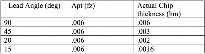

Here is the calculation applied to some lead angles that we see in typical tools.  High feed mills are typically going to have a lead angle below 20 deg.
You can now see how dramatic the axial chip thinning effect can be from using extreme lead angles to create high-feed milling tools.  In the case of a 20 deg lead angle, we would need to feed the tool 3x faster compared to a standard shoulder mill to generate the desired chip thickness.

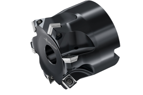

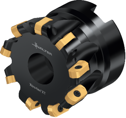

A button insert is how the concept of high feed milling was introduced to machinists.  Since the cutting edge is curved, the lead angle really depends on the DOC being applied.  The lead angle, in a case like this, is taken as a line tangent to the cutting edge, in the middle of the DOC.  For example, if the button insert is at maximum DOC, the lead angle would be calculated at ¼ the diameter of the insert, and the tangent at this point would be 45 deg.  However, if the DOC is only 10-20% of the insert diameter, we get an extreme lead angle and the tool behaves as a high feed mill.  Additionally, if you are only using a small percentage of the insert cutting edge, this will allow more cutting edges per insert.  Possibly even up to 8 indexes per insert like this one.

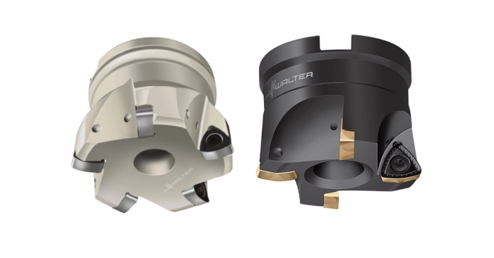

The button insert design can be slightly limiting.  A larger radius will allow us to make the effect of the lead angle even more extreme.  But an extremely large button insert is not economical, nor practical.  Tool designers started adding large radius for the insert cutting edge but only including a small arch of the radius that is required for machining.  This allows for a large radius to be included on a small insert footprint, many times these inserts are triangular or trigon shaped.  Further, these trigon-shaped inserts can be positive basic shape or negative basic shape.  The tools will perform completely different based on this basic insert shape and so the choice needs to be made between a light cutting and versatile high feed mill or is a stronger insert with higher tool life more advantageous.

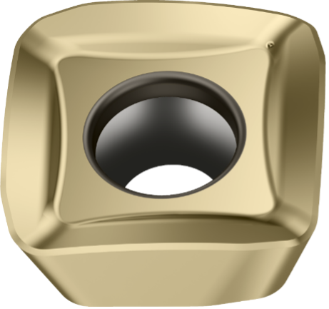

High feed mills with 4 edged square inserts are another common design.  The square insert is simply spotted at the desired extreme lead angle.  A couple of notable differences compared to the other designs being discussed are that this is the first design that uses a constant lead angle.  The button insert and triangle-shaped inserts with large radius all depend on the depth of cut to define the average lead angle.  But, one of the main advantages is that it incorporates a very simple and common insert design.  This would typically translate to a lower cost of the insert due to either smaller size, or the lower cost to manufacture.  It may also be possible that this common insert may be used in another cutter body design, somewhere else in the shop.
The latest improvement to high feed mills with square inserts is to modify the insert design in an effort to increase the performance.  While this is getting away from the advantage of selecting this insert style, improving performance is always a good thing.  The focus of the design change is to increase the thickness of the insert.  Making the insert stronger and more stable by the inclusion of more carbide allows higher advance per tooth and increased material removal rates.  The new design can actually include a large radius along the cutting edge mimicking a design concept from the other feed mill styles.  This will ease the way the insert enters the material and have the effect of making a softer cut with the tool.

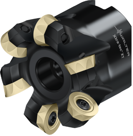

Another advantage of the square insert design is that the insert can typically be very small.  The triangle inserts mentioned earlier and even the button inserts, can typically be somewhat large.  This limits the number of inserts that can be included in the cutter body.  The large inserts require large pockets and deep chip flutes consuming a large percentage of the tool diameter per pocket.
To combat this, tool designers are once again trying to improve the insert design.  Using a narrow insert allows smaller pockets and shallower chip flutes which results in higher density cutters.  Although, making the insert non-symmetrical can limit the number of cutting edges.  By making the insert a negative basic shape, the number of cutting edges can be doubled allowing the insert to be indexed 4 times.  The advantage now becomes using a high feed mill, capable of extreme advance per tooth, and incorporating a large number of teeth in the tool.  The overall feed rate of these tools can be extremely high.  And, it is recommended to check the machine’s capability before selecting this style of high feed mill.
