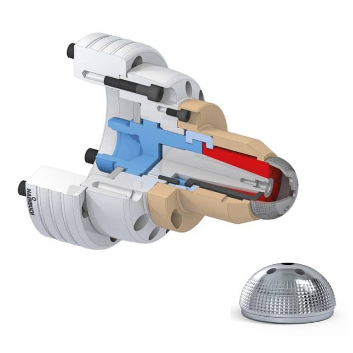

The Hainbuch MANDO mandrel holds the ID of an acetabular cup for machining with only a 4-mm clamping area, yet without marking the part.(Provided by Hainbuch)
Hold on Tight
In any machining operation, maximizing tool life and imparting surface finish quality starts with secure workholding. And in medical manufacturing, the target can be a mirror finish on a part made from stainless steel, cobalt-chrome, titanium, or ceramic. Luckily, companies like Hainbuch America, German-town, Wis., and Destaco, Auburn Hills, Mich., offer solutions that deliver the required rigidity without damaging the part surface. Take Hainbuch’s latest micro mandrel from its MANDO Mandrel line. It uses segmented clamping bushings to hold the ID of a part down to 5.5 mm in diameter (the previous limit was 8 mm), and the bushings are specially treated to prevent clamping marks.
The MANDO T212 conquered a recent challenge to turn the ball profile of the acetabular cup used in a hip joint implant. Michael Larson, marketing director for Hainbuch, explained that the part’s ductile stainless steel required high cutting forces, yet even minimal clamping marks would scrap the part. The MANDO T212 held the ID with only a 4-mm clamping area and without a tail-stock, such that the customer was able to apply high cutting forces without marring the ID and then ultrasonically clean the part.

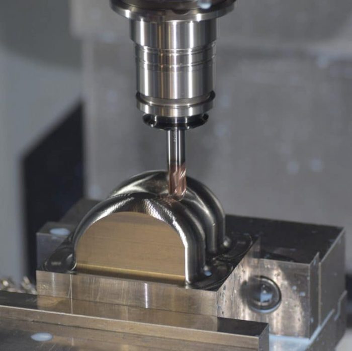

A Millstar BM4T ballnose endmill from Cole Tooling Systems machines a femoral knee implant. All four flutes come to center on this tool, maximizing material removal rates while maintaining a fine finish. (Provided by Cole Tooling Systems)
Getting the fine surface finish required on a part like a femoral knee implant takes a good ballnose end mill. But this leads many people to either machine slowly with a two-flute tool or to problematic machining with a four-flute tool, as Stuermer explained. “In theory, a four-flute ballnose should be twice as fast as a two-flute version. But traditionally two flutes stop short of center on a four-flute tool. To achieve a superior surface finish, you have to take a fine step-over. With a light finishing pass, the two flutes that stop short of center will easily be beyond the depth of cut, so it is really only cutting with two flutes. If the feed rates are set twice as fast, thinking you’re cutting with four flutes, the finish will suffer.”
What is more, the small chips produced by this cut tend to get caught in the gap between the end of the flute and the center, then drag across the part, leaving marks. The solution, said Stuermer, is a “true four-flute” ballnose tool where all four flutes come to center, which Millstar calls the BM4T. “You can double the feed rate, because you are using all four flutes of the tool. The other advantage is that you’re not driving the chips across the part.”
Stuermer also observed that medical manufacturers have hundreds of machine tools with smaller, less rigid spindles than machines commonly used in other industries. This limits the size of the tooling they can use effectively. To address the need for increased productivity without changing machines, Millstar has introduced a new line of ABL milling tools. These tools feature a large radius on the end face, typically as big as the diameter, creating what is sometimes referred to as a lens shape.
“You can take twice the step-over and still get the same surface finish,” said Stuermer. “We’re also experimenting with combining this shape with a barrel form on the side.” He added that although the achievable surface footages in these materials may be low compared to easier-to-machine materials, “the new geometries and coatings still make dramatic improvements, like the difference [in moving from] 300-400 sfm finishing in titanium to 700-900 sfm.”

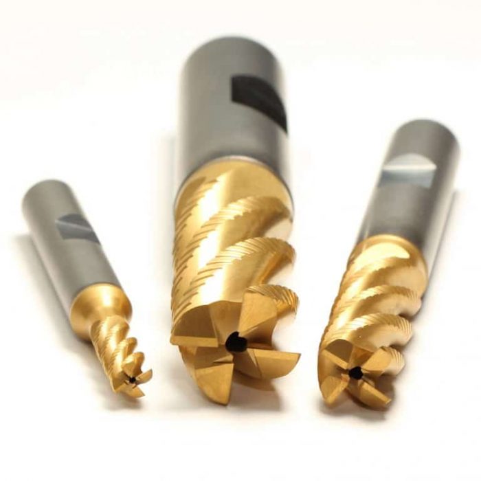

Dan Doiron, milling product manager for Emuge Corp., West Boylston, Mass., also highlighted the importance of tool coatings. Its TiNox-Cut material-specific end mills feature a high-heat-resistant, PVD-applied, multi-layer TiN/TiAlN coating. Doiron said the series was developed especially for machining titanium alloys, nickel-base alloys and stainless steel. The product range consists of solid sub-micro grain carbide end mills with variable flute spacing (for vibration dampening); optimized geometry for long chipping, tough materials; and h5 tolerance shanks with a roughened surface (non-polished) for greater gripping force.
Emuge’s TiNox material-specific end mills feature a high-heat-resistant, multi-layer PVD TiN/TiAlN coating and were developed especially for machining titanium alloys, nickel-base alloys and stainless steel. (Provided by Emuge)
“Roughing and semi-finishing and finishing profiles are available,” and finishers are available with a flute length-to-diameter ratio of up to 4:1. Doiron added that its Top-CUT VAR general-purpose end mills are an economical option for “nearly all materials and milling strategies due to their special geometry properties.” They’re made with premium solid micro-grain carbide and feature variable helix flute angles for vibration dampening, a tapered core diameter for added stability, and high-performance AlCr coating for added wear and heat resistance.

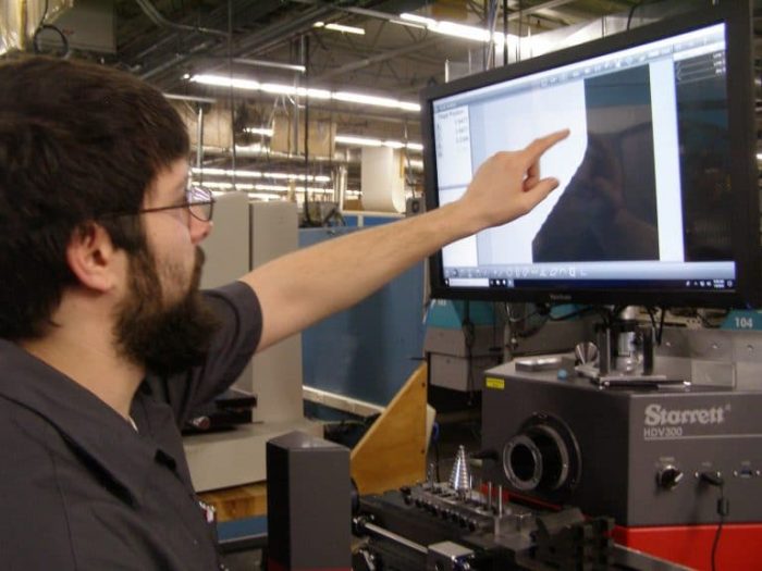

Starrett’s walk-up metrology concept lets machine operators inspect parts right on the shop floor, so they can make fast adjustments to their process. (Provided by Starrett)
Users include orthopedic implant manufacturers for knee and hip joints and bone screws, to name a few. “They use it for in-process measurement to improve their process and to reduce scrap,” explained Arenal. “Depending on the number of features you measure, it can be very fast. In the case of a knee, we hold the knee joint on a fixture on a rotary table and rotate that knee through a variety of section views and then measure the profile at each stop along those cross-sections. This allows us to effectively get a 3D measurement of the part.”
To measure features on the surface of a part (as opposed to the edge profile), Starrett offers a variety of lighting techniques, including dark field illumination, coaxial illumination, and segmented LED illumination. Arenal said “the whole idea is to illuminate the feature effectively so it stands out and you can grab the feature detail. Our tools give the user options to see difficult details on parts.” For example, on a molded part with black-on-black features, the edge of the feature will only be pronounced enough visually by casting light at an oblique angle. “That’s where surface illumination techniques come in,” he said.
While the tools are powerful and the software interface intuitive, such cases require an experienced operator to get the right information. “This is a level of technology that’s evolving, but it’s important that an engineer or operator knows the part they’re verifying and that they’re actually seeing the right points, given the variability of small features, which are sometimes in close proximity to other details,” said Arenal. “On the more challenging applications we haven’t eliminated the need for a qualified technician to set up the part program to begin with.” It’s also possible to integrate touch probes for measurements where that’s the best method, and laser sensors for contour, profile, and surface finish measurements.
Arenal added that all Starrett systems are “usable for what we like to call ‘walk-up metrology.’” “Walk-up metrology” means two things to Starrett. First is the ability for any mill/lathe/grinding machine operator to “take a part out of his machine, put it on a nearby Starrett measuring system on the shop floor, click the right part program, and run that part right there, rather than taking the part down to the quality lab and waiting for a first-article inspection.” The operator can quickly make any needed adjustments to his machine or process. “It’s a much more efficient way to keep production moving,” he said.
Second is the ability to quickly measure a few features on a new part without any pre-programming. This last capability rests on the “discoverability” of Starrett’s software. “It’s almost like the experience of using a smartphone, with common functions across all machines,” explained Arenal. “Everything is a touch screen.” For example, if the entire bolt circle of a small hub is visible, the operator can touch each diameter on the bolt circle and then touch the center of the hub. They have then created a bolt circle and can use easy construction tools to create angles between each hole in the circle and the center, according to Arenal. “I can then switch between the graphics screen, or the feature in detail, or the actual live video view,” he said.

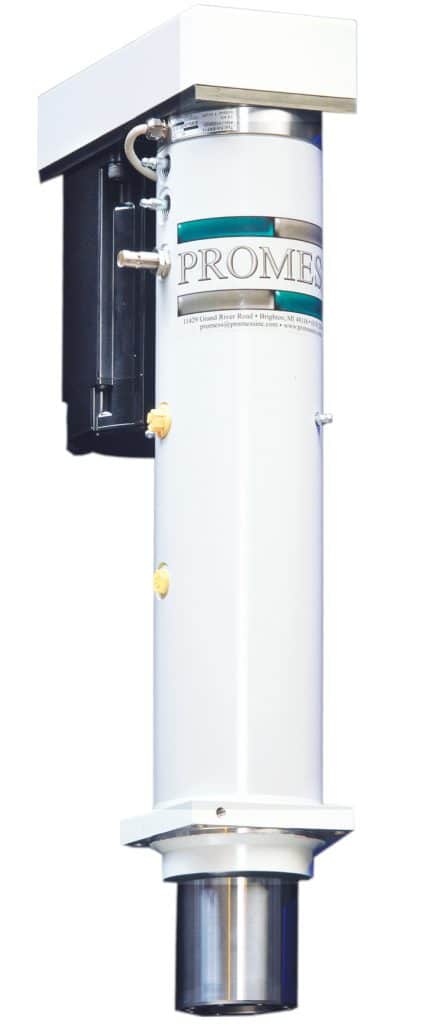

The Promess Electro-Mechanical Assembly Press promises delivery of a consistent force when assembling a vascular closure device. (Provided by Promess)
“These issues were costing the manufacturer thousands of dollars in reworks and end-of-line batch checking,” said Nausley. “Promess offered our Electro-Mechanical Assembly Press, EMAP, with integrated force versus position monitoring as well as a TorquePRO system for functional testing of the final assembly.”
After Promess application engineers found the proper forces for the housing to be assembled and the necessary torque for the release mechanism functional test, the EMAP allowed the customer to press to the same force within ± 0.5 percent every time. “With the TorquePRO now conducting a functional test on every vascular closure device, the manufacturer was able to ensure 100 percent in-process verification that every assembly was done correctly. This eliminated the need for end-of-line batch checking and gave them individual part traceability,” Nausley said.
